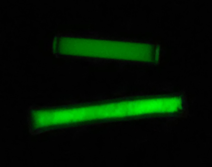

@puzbiks1 @Birdhandz how does the powder compare to a similarly sized tritium tube? It should be viable to seal one end of the glass tube, tamper in the powder so it is nice and compact, and then seal the other end using the methods on the site I linked to. This looks very promising if the powder can have the same light output, especially not needing two layers of glass and being rechargeable.Is quarts biosafe? I might try to dabble with some prototyping myself. I know the firefly used borosilicate, and rfid tags use the schott bioglass. If quartz is even stronger than both these and still biocompatible that would be great.
This picture isn't really similar size but the glow powder I have does seem to be at least as bright as the tritium vial. The tritium vial is not one of the implantable ones but just one I got off ebay a while back.

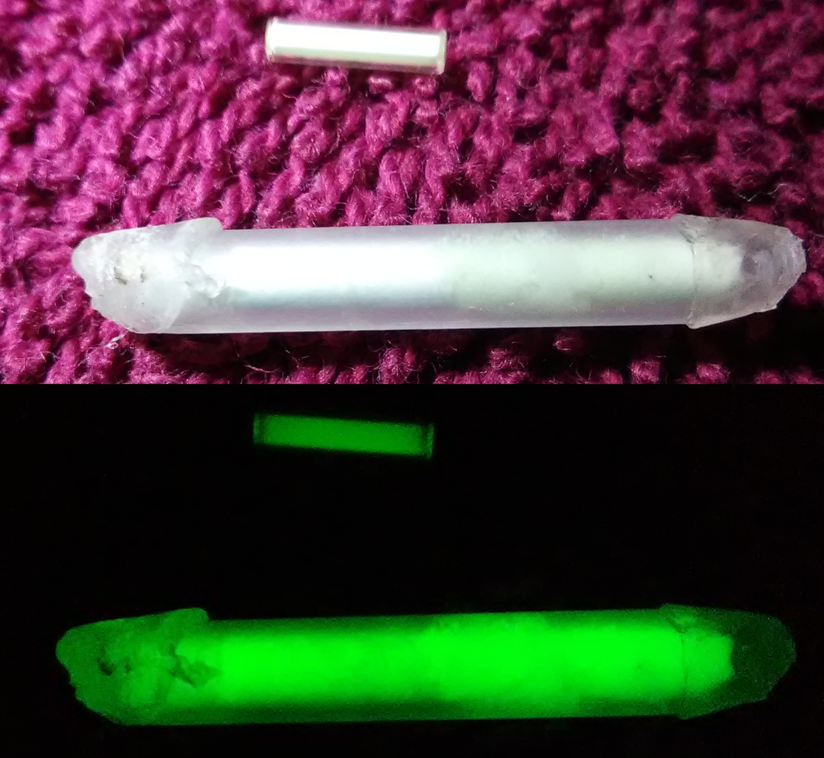

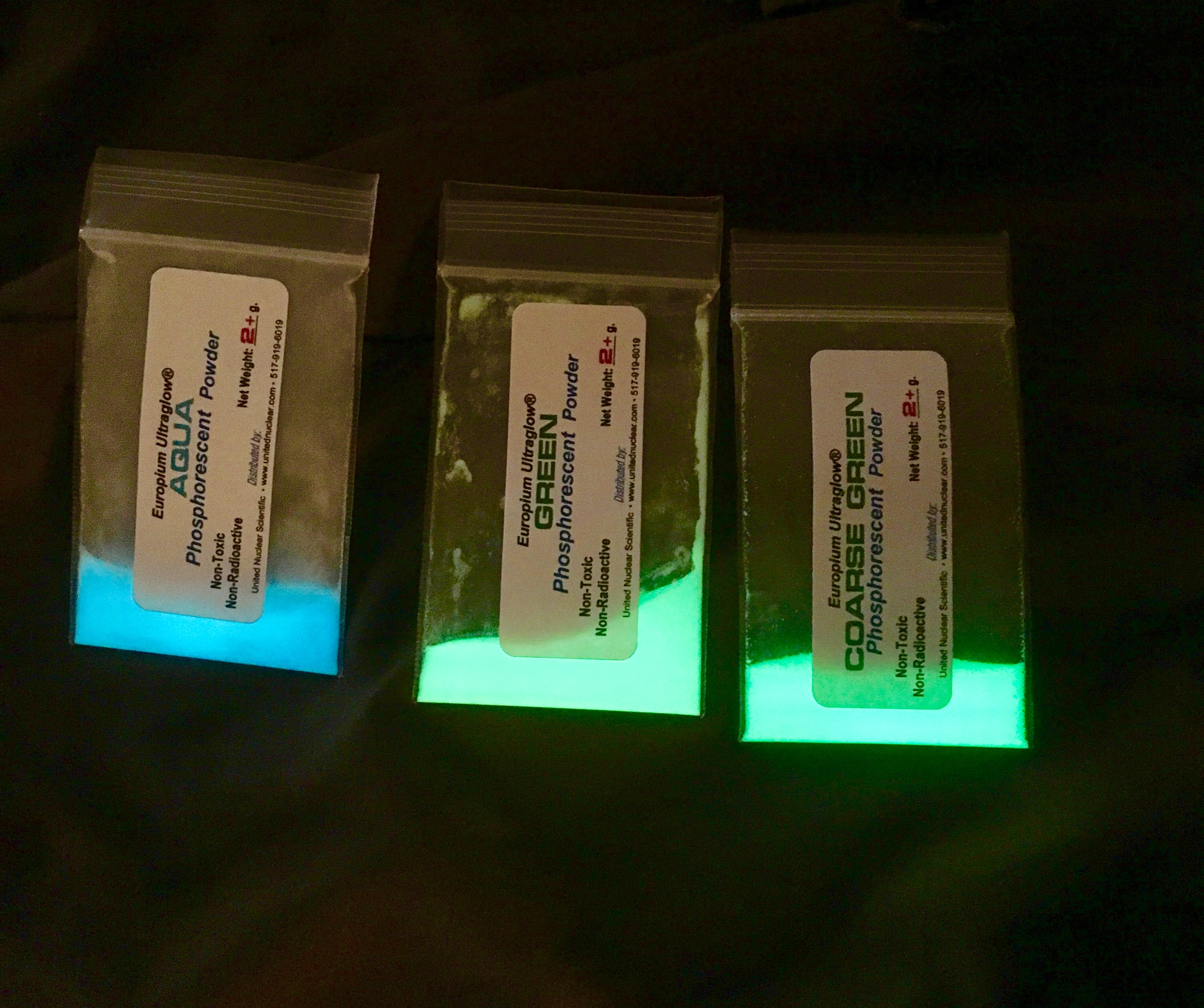

Ok this stuff is pretty fricken cool. These are the brightest three colors, the others weren't bright enough to be worth it.
@Johnny3D that is awesome. Put some of that in a glass vile and shove it into some meat. Wondering what the results could be.
@Semilovr12 said:
@Johnny3D that is awesome. Put some of that in a glass vile and shove it into some meat. Wondering what the results could be.Here's some of my ebay bought glow powder packed into an ink tube from a normal size ink pen. The tritium vial is not the ones sold for implanting but just one I bought off ebay.
The length of the ink tube is almost 1 inch long but I wasn't sure I could melt it closed and didn't want it too short. I have no intention of implanting this but just wanted to see how bright it would be. I could have spent more time sealing the ends but this was just a test.
It was charged up with a small LED flashlight. Using a black light would have made it even brighter.
Here's one closer to the same size. This one was made from some real small tubing (unknown type) that covered the leads of an LED. It was harder to pack the powder into the tiny tube but it is similar size to the tritium vial I have.

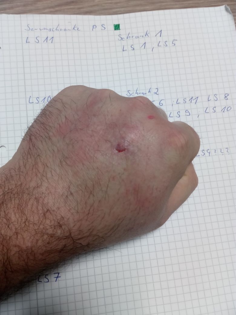

Hello to everyone,
First of all sorry for my bad englisch, I’m from Germany and the last time i spoke englisch was in school about 16 years ago.

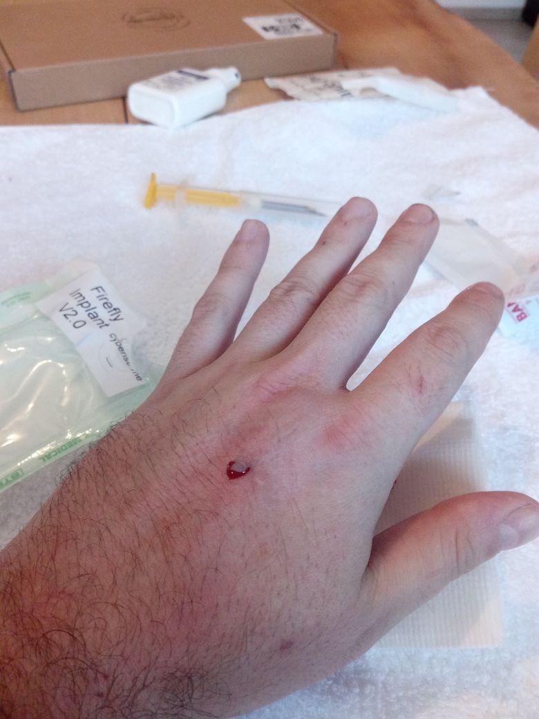

My name is Flo and i orderd a Firefly v2 a few days ago. It arrived 3 days ago and i implanted it immediately.
Last night i saw it glow for the first time, i dont understand why people in this thread need 10 days to see it glow, Its not super bright but i think it will be very bright in a couple of days.
If i go in a dark room (not that one) now, i will not see it, my eyes have to accustom to the dark but than you can see it very clear. Unfortunately i cant take a picture of it, but i have a few from the implantation.
The wound right after
And this is the wound now after 3 days.
Feel free if you have any questions.
At least i wanna say thank you to Alex for the good service and the good work he did
(i love the rattle of the Firefly too :D ). -
your hole looks the exact same as mine did hahaha
