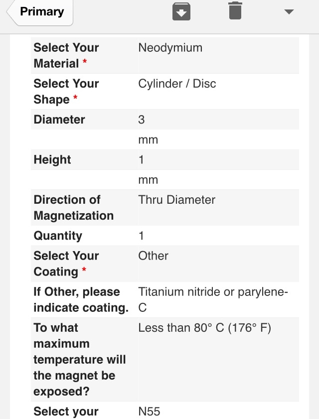

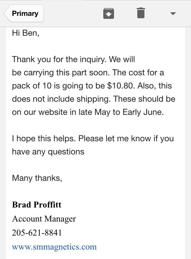

Not sure if this has been said yet (not on computer so I can't CTRL-F it) but I just emailed supermagnetman.com and apperently they'll have N55 3x1 titanium nitride/parylene-C magnets for sale, late May early June!

Not sure if this has been said yet (not on computer so I can't CTRL-F it) but I just emailed supermagnetman.com and apperently they'll have N55 3x1 titanium nitride/parylene-C magnets for sale, late May early June!Are they trustworthy?
I ordered 20 of them and intend to test them when I get them. I have a friend who is willing to try them with me if they pass the saline test/ any other test I can run. I will post any info I find on them as well as photos.
@Fireice289, have you ordered the 0.75mm x 1mm ones? Would they be big enough?

I ordered 20 of the 3mm x 1mm parylene coated magnets. all 20 failed testing. This was done more to see if the magnets were viable for more than one attempt. Each magnet had multiple points of oxidation which leads me to believe that they are not coated in such a way to make the cost of a second coat reasonable. Most magnets had at least three points where significant oxidation still occured with my best one only having two small points, however I am not at all comfortable with the results and would not recommend them for this use and will not be using them as such.
On the plus side the are pretty good magnets all in all so i am sure i will find some use for them. They are quite high quality, just not good enough to trust my longterm health on
