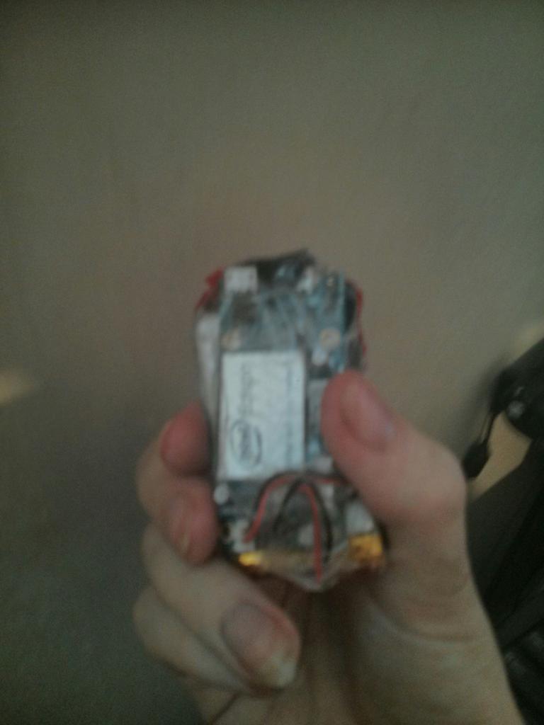

  9. I've got the edison and some support circuitry (battery + qi inductive charger) encased in plastic and i'm starting to coat it in resin. On the software side of things, it's configured to automatically connect to an open wifi network and broadcast avahi advertisements so I can login over SSH.
  10. Say, were the inductive charging coil and lipo integrated, or separate? Also, what're the size specs as you have everything configured now? Depending on how well this goes along, I might attempt to replicate your device.
  11. By kilo I assume you mean the lipo - no, they weren't integrated. What i've done is taken the edison and the mini breakout board, attached a lipo to the breakout board (it has a battery charger integrated) and plugged in a Qi to micro USB charger then wrapped it up in plastic film and painted with liquid tape to seal it. In terms of size, I don't have a measuring tape to hand but here's a picture: https://pbs.twimg.com/media/COnsB31WEAA2TOX.jpg
  12. You really could've minimized that a lot more. Those JST connectors at least should've come out.
  13. If I had the soldering skills for it I would have put a lipo charger wired directly up to the edison on its own, which would make the whole thing way smaller. Sadly my soldering skills suck.
  14. That level of soldering skill is pretty basic, you should be able to do that much or find someone who will pretty easily.

  18. On the breakout board that'd be simple, but on the actual edison itself it wouldn't be. For those not familiar with it, the edison itself only has the 70-pin connector on it, to get USB you need to use a breakout board.
  19. I see...The Edison is the SD-card-sized micro-computer, right? What about hitting up a lcoal makerlab to have someone there wire up the 2-3 traces needed for the project?
