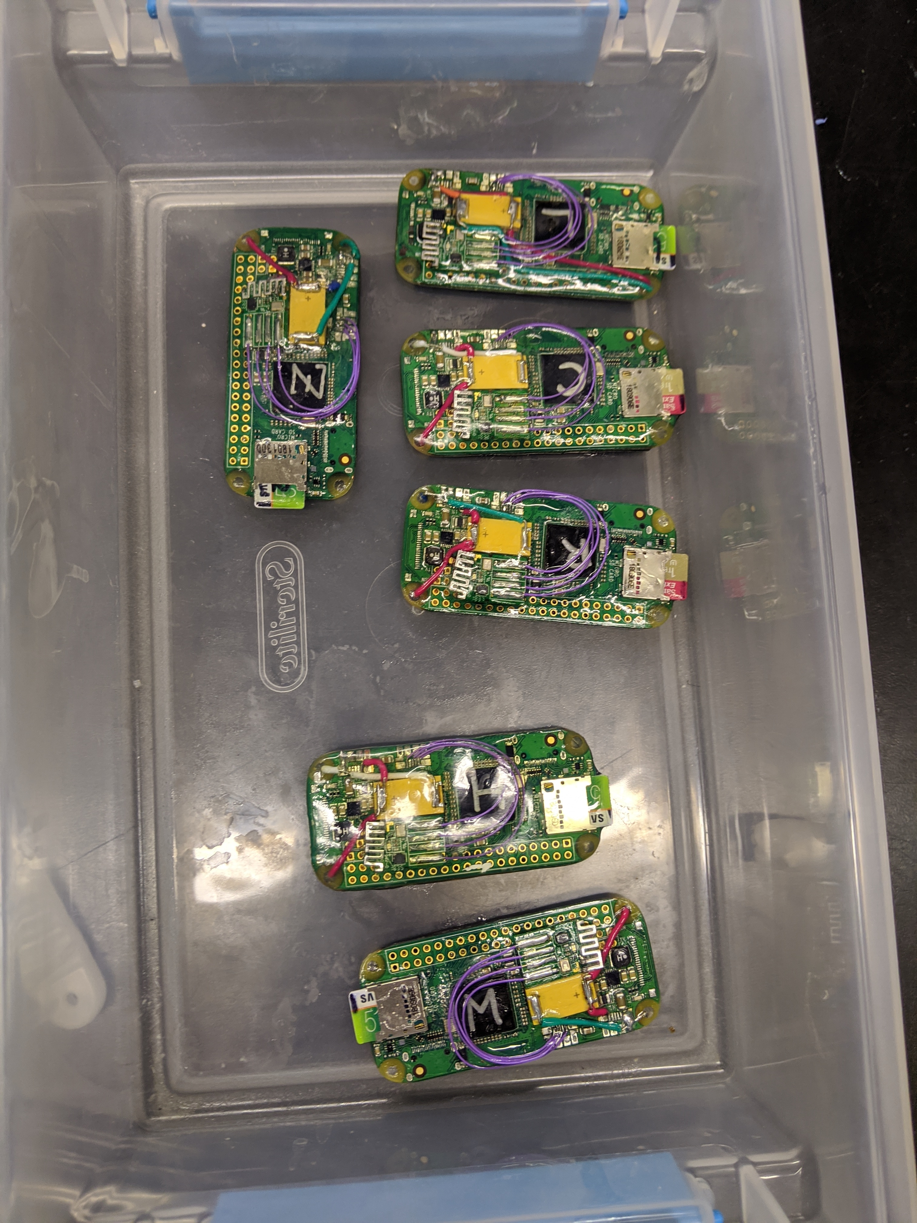

  4. Damn, that's some hacky shit. New peglegs? I've been into that flywire shit before with some of my projects, but I've never encapsulated them in bioresin XD more power to you, man.
