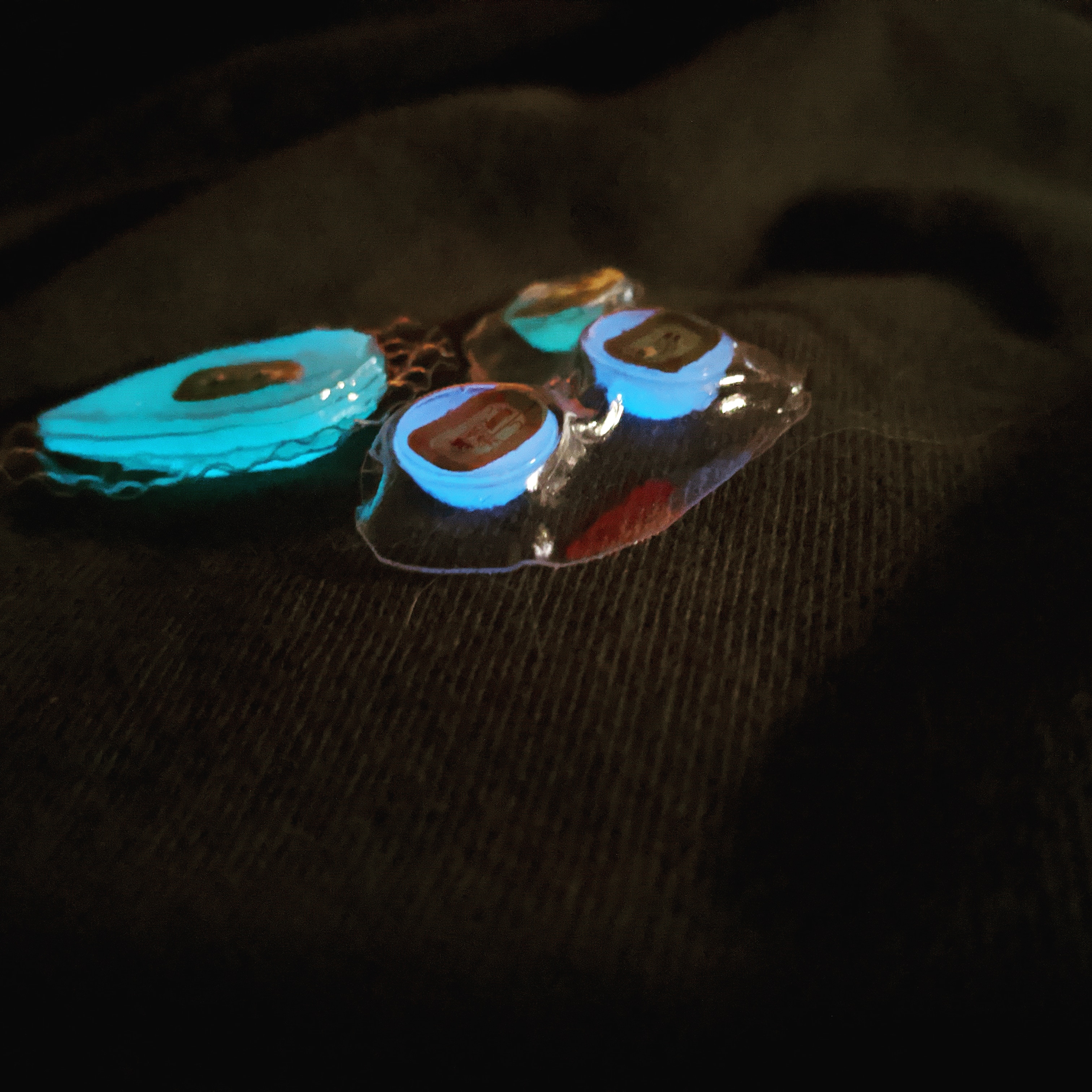

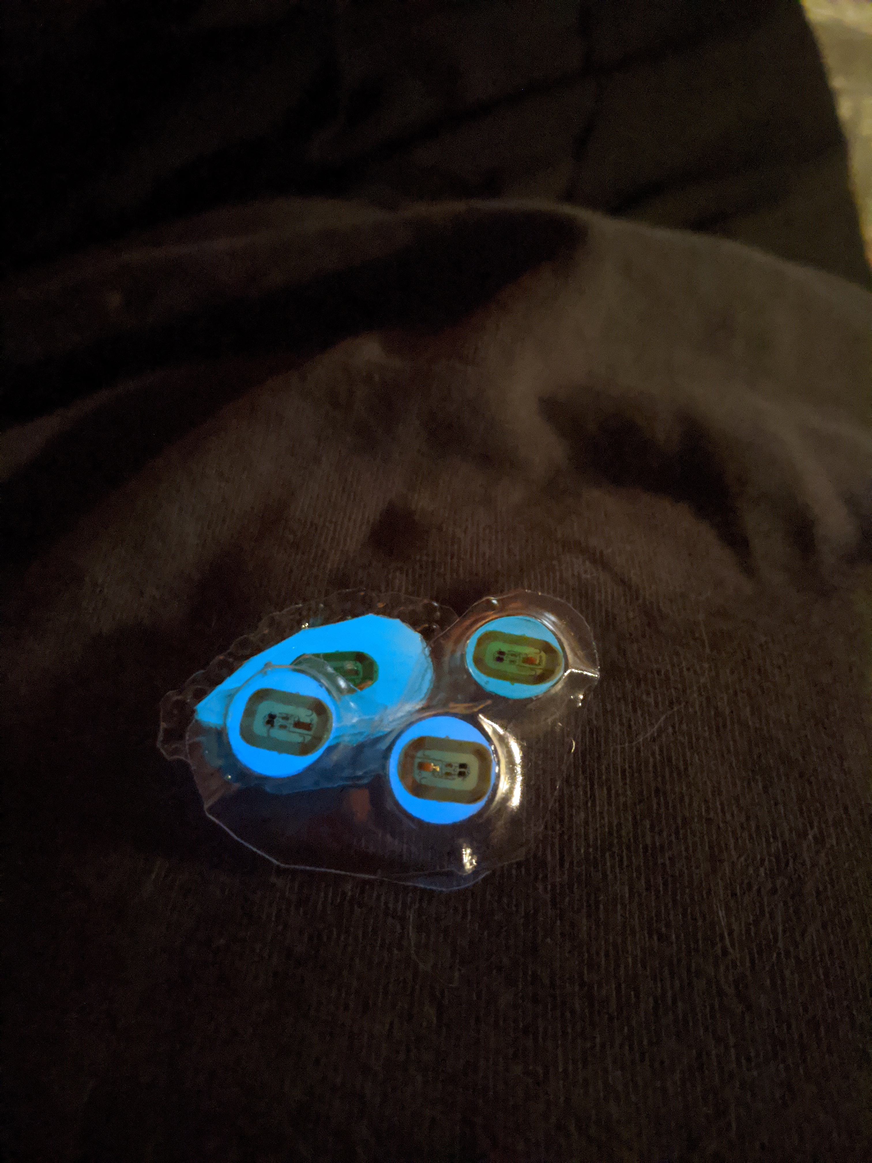

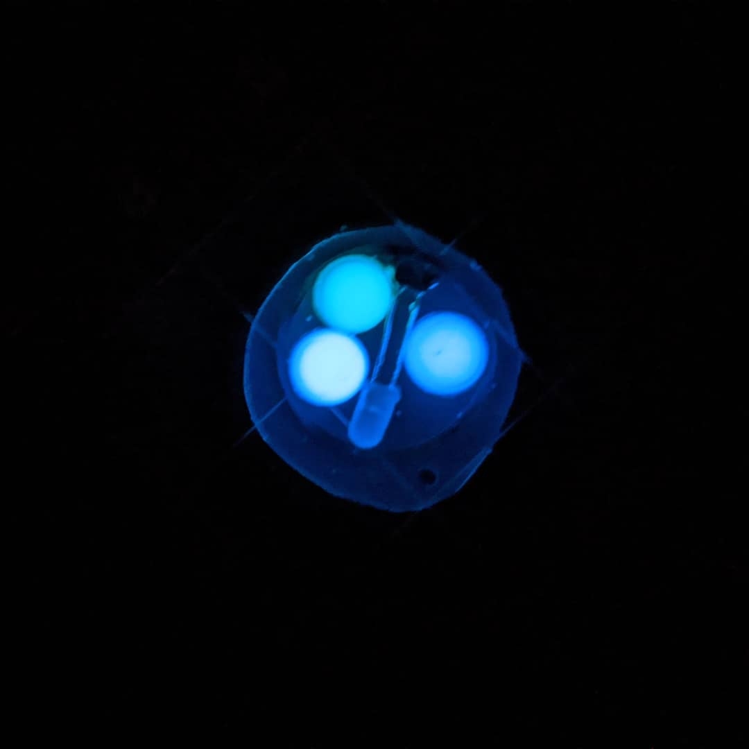

These use a glow pigment which is charged by the RFID light. -
hey this may be a stupid question but do you use a vacum so you could get the air bubbles out
they do look amazing so far
Those look great! How's the range on the RFID LEDs? Would the implant need to be placed with the tag side against skin?
No. Actually if you're having problems with air bubbles in resin, try running a blow torch or heat gun over the top. Make sure your resin isn't actually in a flammable solvent first.
For these ones in particular, yes. You'd need to place these upside down. Even worse, these are LED flashers that were gifted to me. So they blink.. which likely isn't good enough for charging up the pigment. A better method would be to do a partial pour.. place the light with the coil close to the surface and they pour more resin.
But, clearly it's all doable. -

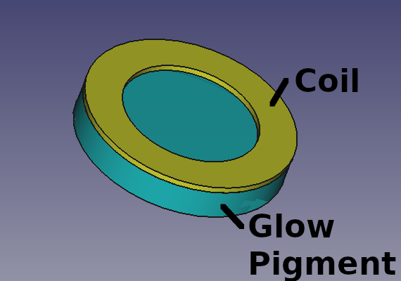

Something like this might work out a bit better. The LED could be placed on the bottom or side depending on which orientation charges the pigment the best.

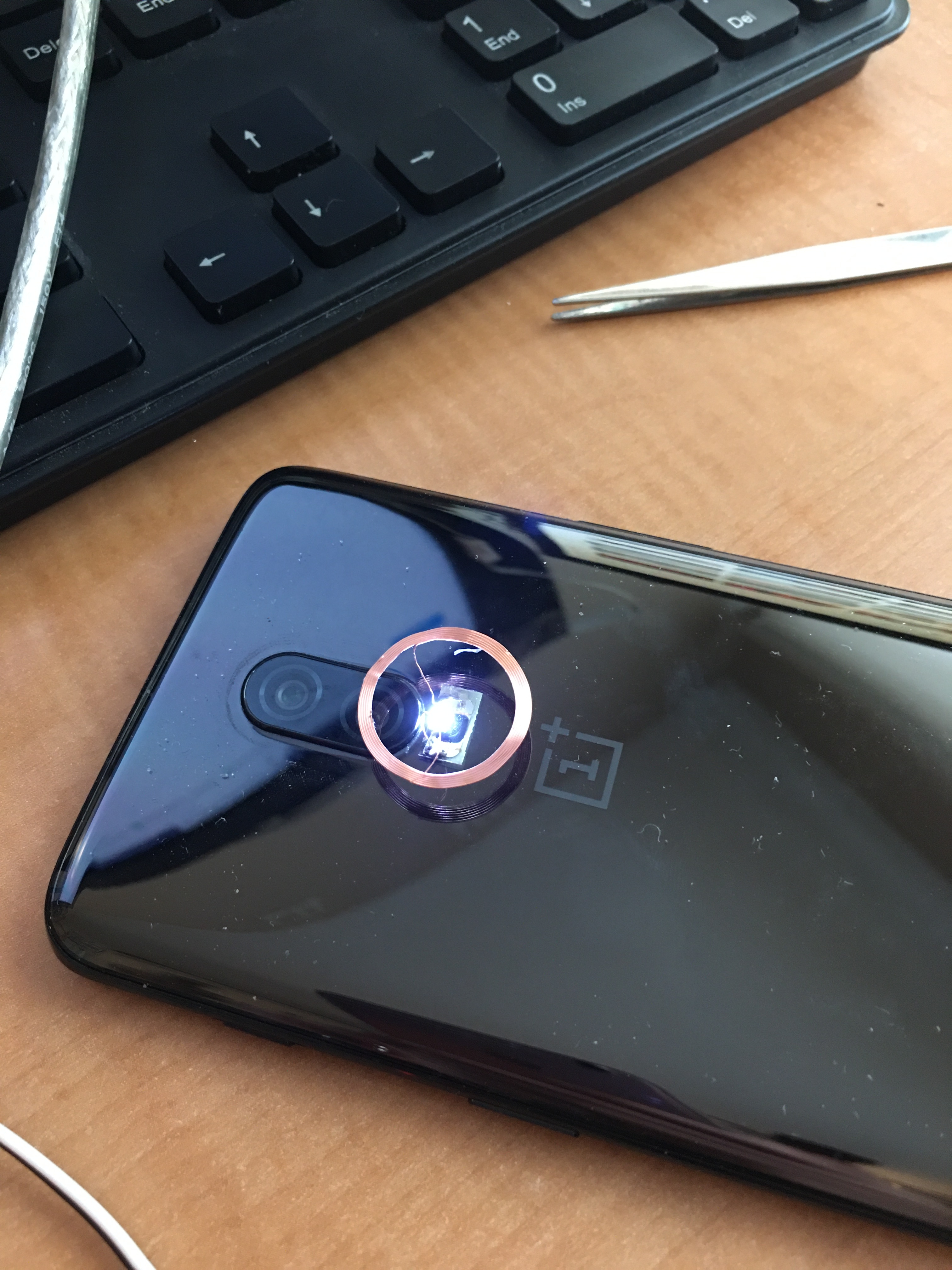

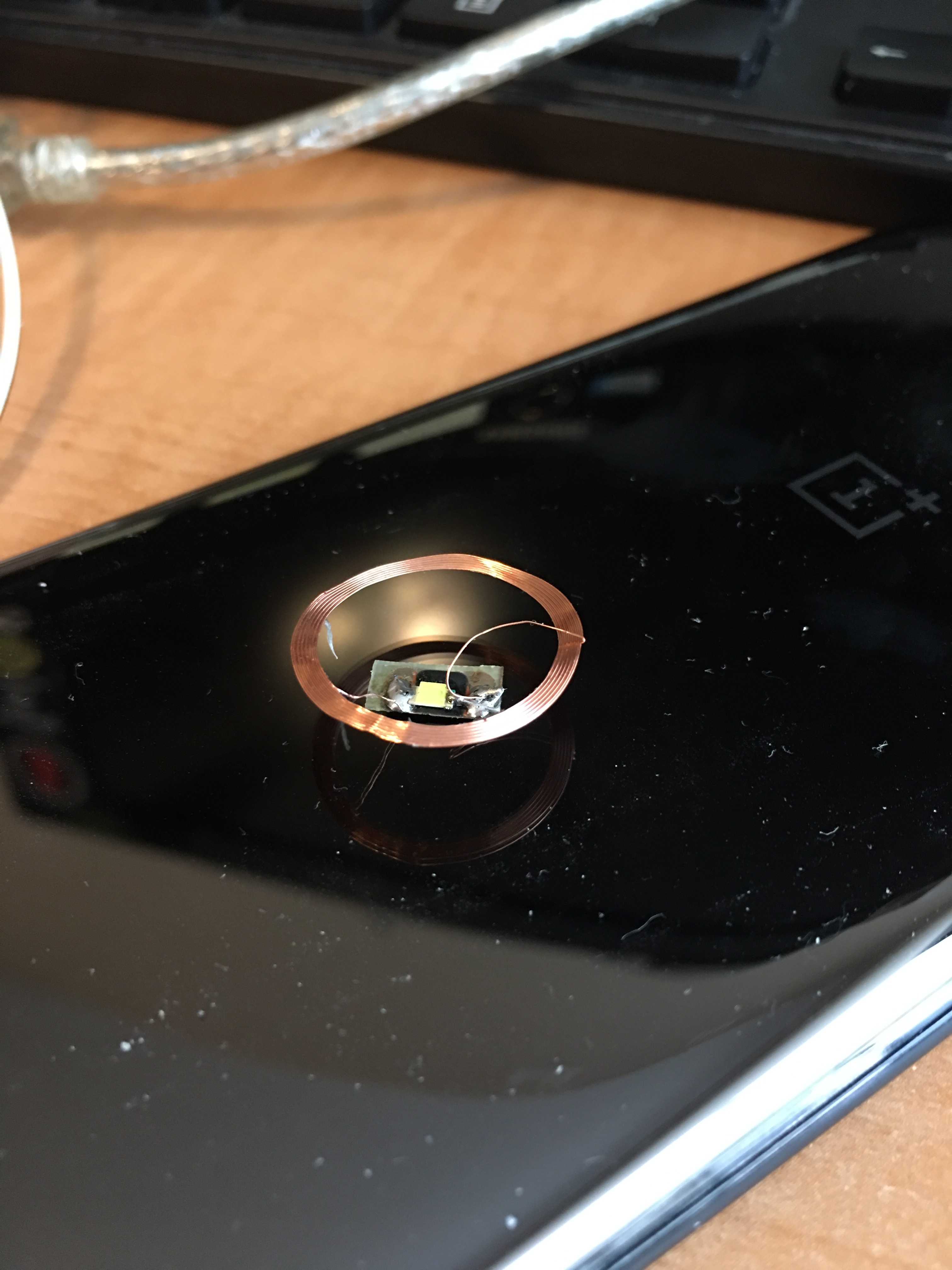

Quick update. I tore open one of those NFC key-fobs, used a bit of acetone to persuade the coil out, and soldered an LED directly onto the pads of the NFC chip. The chip adds some extra functionality and I left it in the circuit because it converts the AC to DC, meaning that the LED won't blink like the nail lights you're using.
I had the coil suspended 6mm above the chip and my phone was still able to power it, though I had to flip it around to get it work work with a PN532 V3.

So, since I have those coils.. where do I solder to?
Depends on what you're trying to do, but the pads of the NFC chip worked out well for me. If you want to solder to another part of the coil, you'll need to scrape off some of the enamel coating from the wire.
For the enamel coated copper wires, to remove the coating you just need to burn it off by submerging the wire in a bead of molten solder on the tip of the iron. It takes a second for the liquid solder to heat up the wire enough for it to enter the bead, but once it does, you can just run it along the length you need. Don't breath that vaporized eurethane, though. Scraping is a nightmare for the thinner gauges.

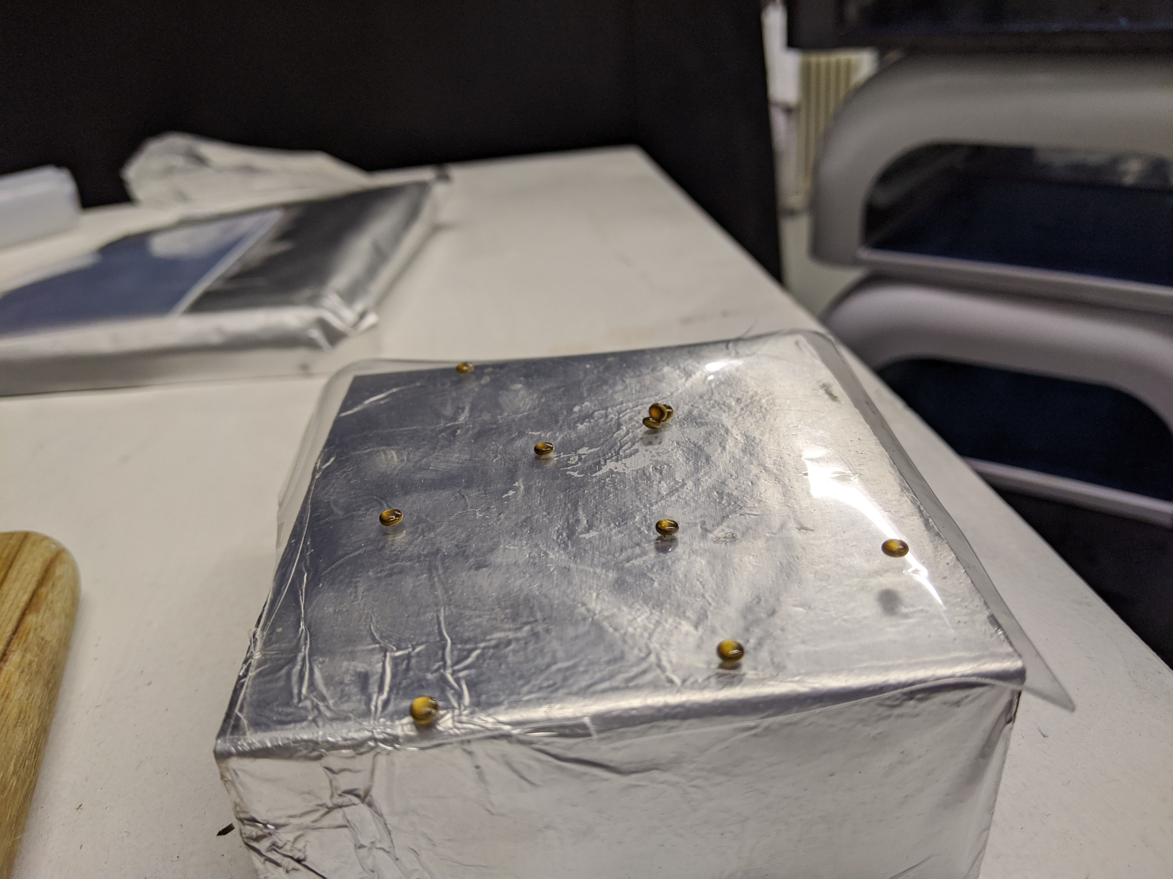

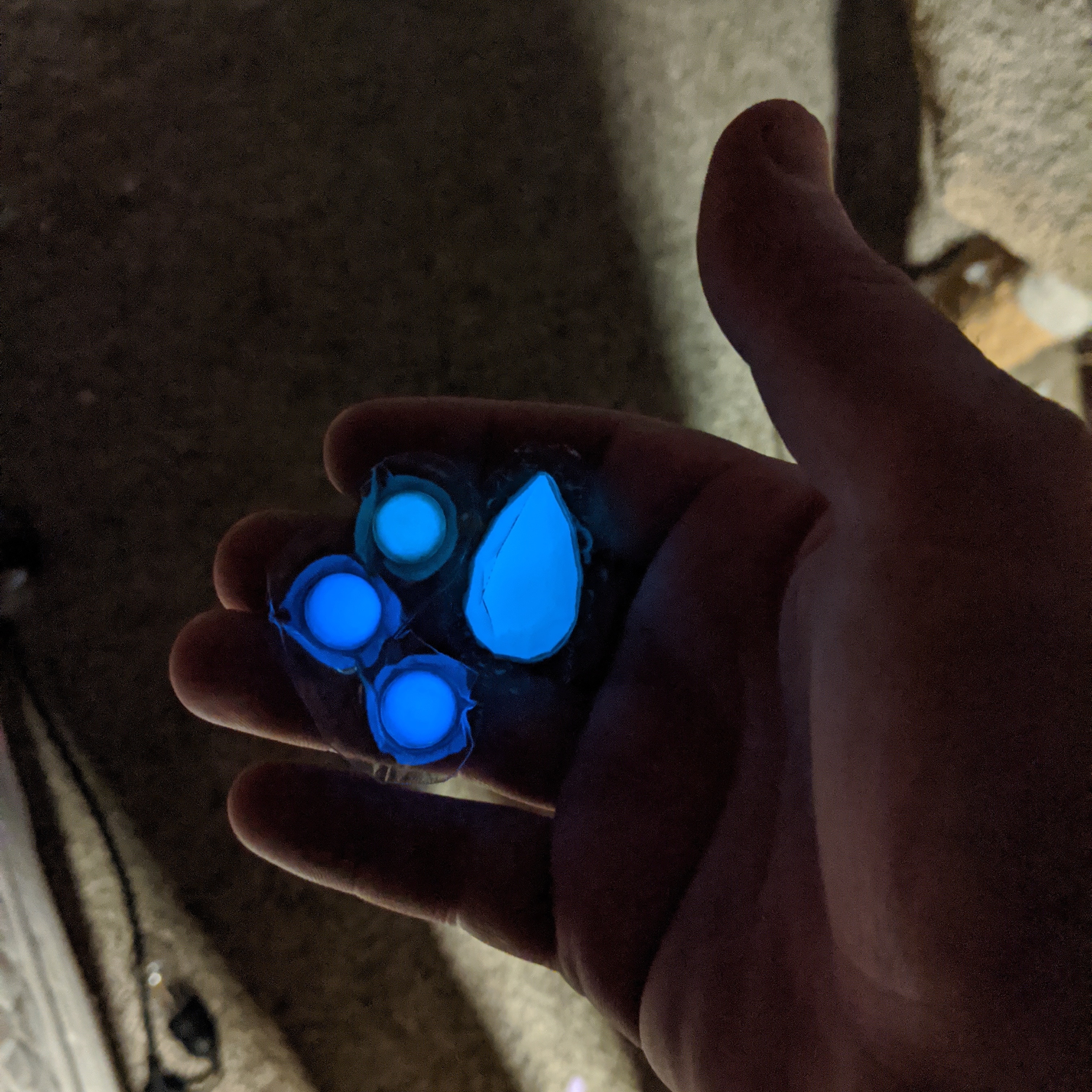

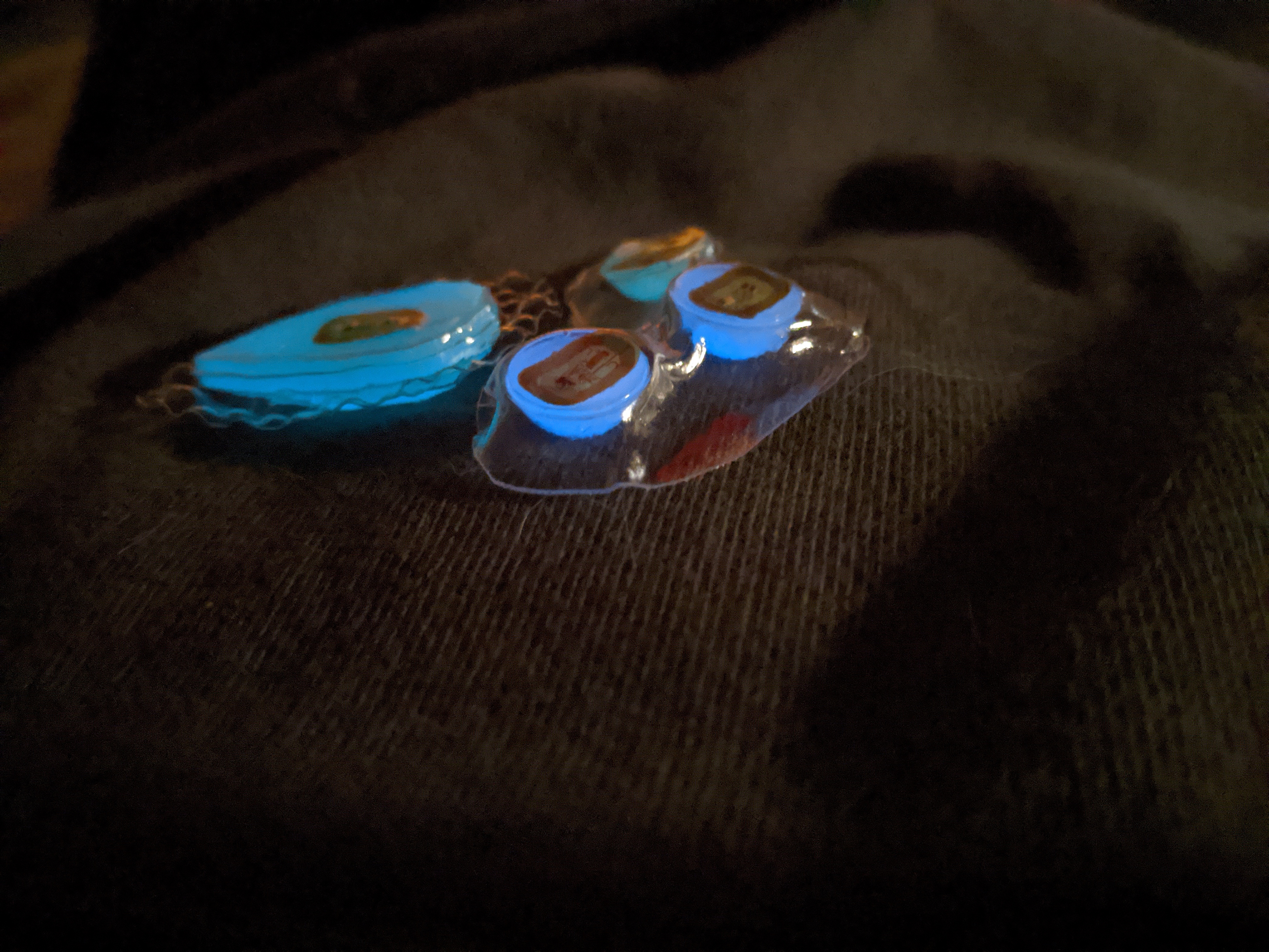

Well, I'm almost there. I'll tell you guys what I'm dealing with and maybe someone has a suggestion. Making hard and durable implants is pretty easy at this point. In fact I've started a new batch of 3mm x1mm. But now that we're working on larger things such as the Pegleg, the hardness is important. So this like acrylic and polycarbonate I've got down. But I'm trying to then coat over the harder plastic with a softer one.
Yes, I know that silicone isnt a thermoplastic but I thought I might be able to shape it a bit with heat. Nope. Gotta wait on the injection molder. Things like HDPE works ok. I really like EVA plastic although I the biodegradability concerns me. I've read some works which ascribe it biocompatible.. but biocompatible and biodegradable usually don't hold hands. I've made a lot of prototypes but nothing I'd consider finished. -
Well, a bit more work. I'll have some finished products in acrylic and TiN.. I have 10 of the 3mmx1mm and 10 of the 5mmx1.5mm. I'll also have some interesting custom units finished this week as well. I'm going to stay listing these on the Auglim site by the end of the week.
