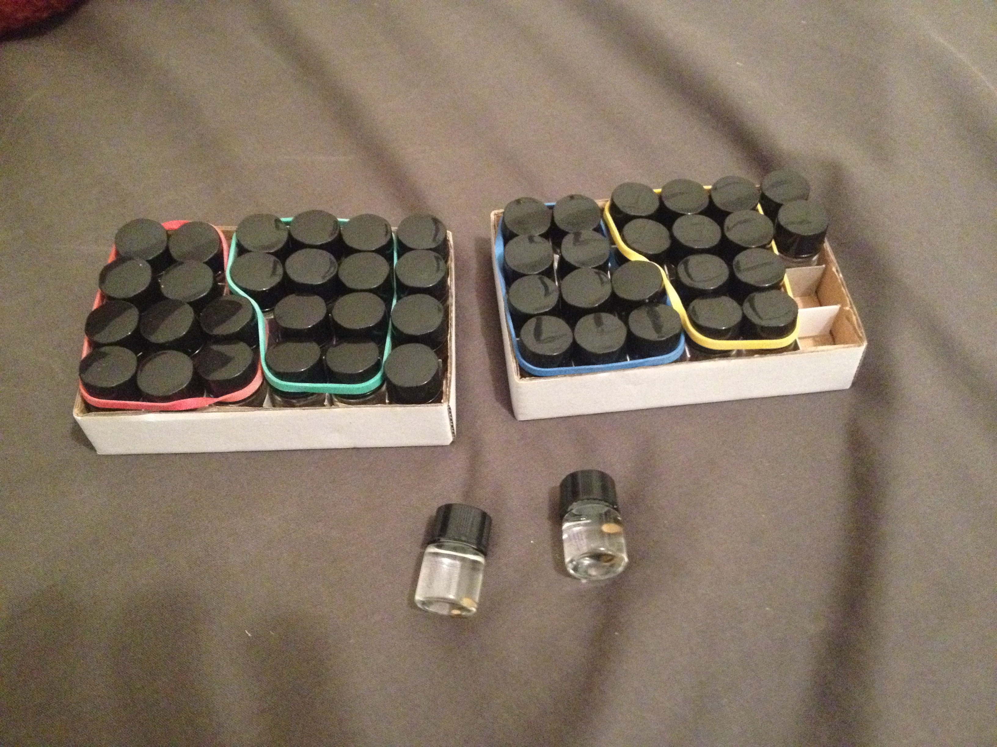

I've started my testing of the SMM magnets which consistes of the following:
48 Magnets, 48 vials, 500ml of distilled water, 10g of salt, 1-2g of odorless/dyeless detergent.
I'm going to try to do daily checks and plot the failures onto a graph to find the date where a 95% confidence is reached.
Awesome. Those are going to be great numbers. So I'm reading this as a 2 percent solution then?
Yeah- I'm using two percent. I wanted to remain pretty close to saline but bumped it up a tad.

SMM 48 Magnet Test:
D1: 5 Failures (A4, B7, C0, C1, C8)
D2-D7: No additional failures
D8: 1 Failure (D0)
I think I'll post an update every couple weeks or so.
