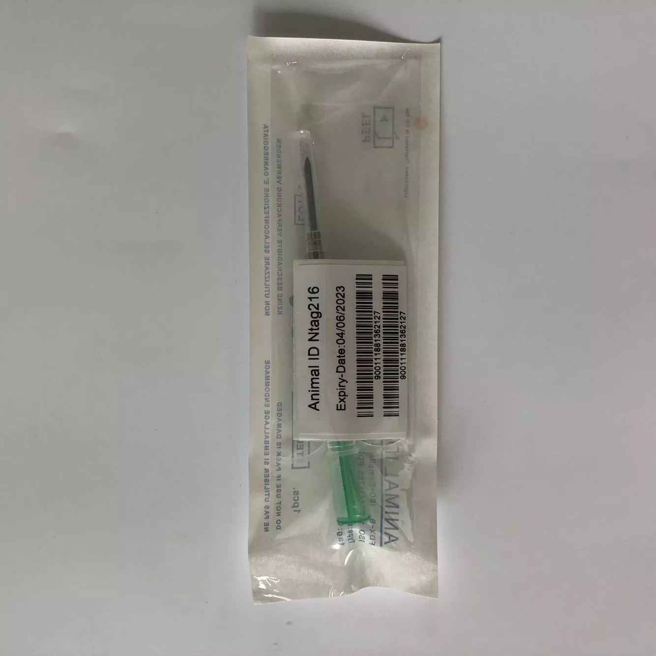

    I checked the majority of supliers on Ali and also the ones you had. At the Ntag216 products there are pictures with ISO 11784 and 85 which is 134.2khz. So now I'm confused, false publicity, wrong typo or I'm just noob?
  5. Can't open the pic from site.
    This pic I got from seller after ringing bells...
  6. Yeah, it seems like they are falsely claiming standards compliance. Mine definitely is picked up with my phone's nfc reader, so I'd assume it's useless at 134.2khz
  7. @rodanco those sellers usually have hundreds of products. They make one or two pages then copy and paste for all the other products. Seems like they just didn't care check the info was correct.
    Could also be false advertising, these tags are for animals and FDX-A, FDX-B,ISO 11784/85 are a big part of that industry.
    I'd stay away from those standards because there is very little DIY equipment available, and you need a reader that can deal with the encryption. 125khz or 13.56mhz will give you the most versatility.
    Unless of course your goal is to get chipped and have a vet scan you...then everything I said is pointless.
    Best is to always question the seller and get the info directly. Later I will post my story and trouble so far regarding that.
    I can't see your photo btw.

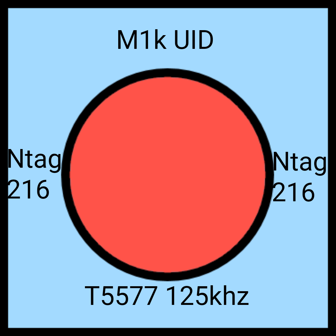

  9. @Nama Once again, I'm not looking at these now to implant and I said if I need one tomorrow will definitely be DT, we are all just investigating niw... I want to make a ring with 2X ntag216, 1X 125kHz and 1X mifare classic 1K with UID changeable (here I didn't found capsules only coils so will try to "reshape" those)...
  10. @rodanco I just ment that the animal specific encodings used will be a pain for reading/writing. I was looking at a 134.2khz with 'memory' also but couldn't find equipment that said for sure it would write to the memory section.
    one ring to rule them all?
    For the ring you prefer the capsules over open coil?
    Changing the coil shape will change the resonate frequency but I'm not sure how much in your case. If it is only a little then you lose a little range, if it changes to much then the chip won't get power. If you could recoil the antenna then you could keep the range.
    Or you might be able to break a capsule and replace the chip with a 1K chip from a card

    Added a schetch of my idea. Except the Mifare with backdoor l, all will be capsules, maybe with a tritium one also for night guidance. Will try to figure it out with the antena...
    So the ring is like the sketch, square and fully transparent
