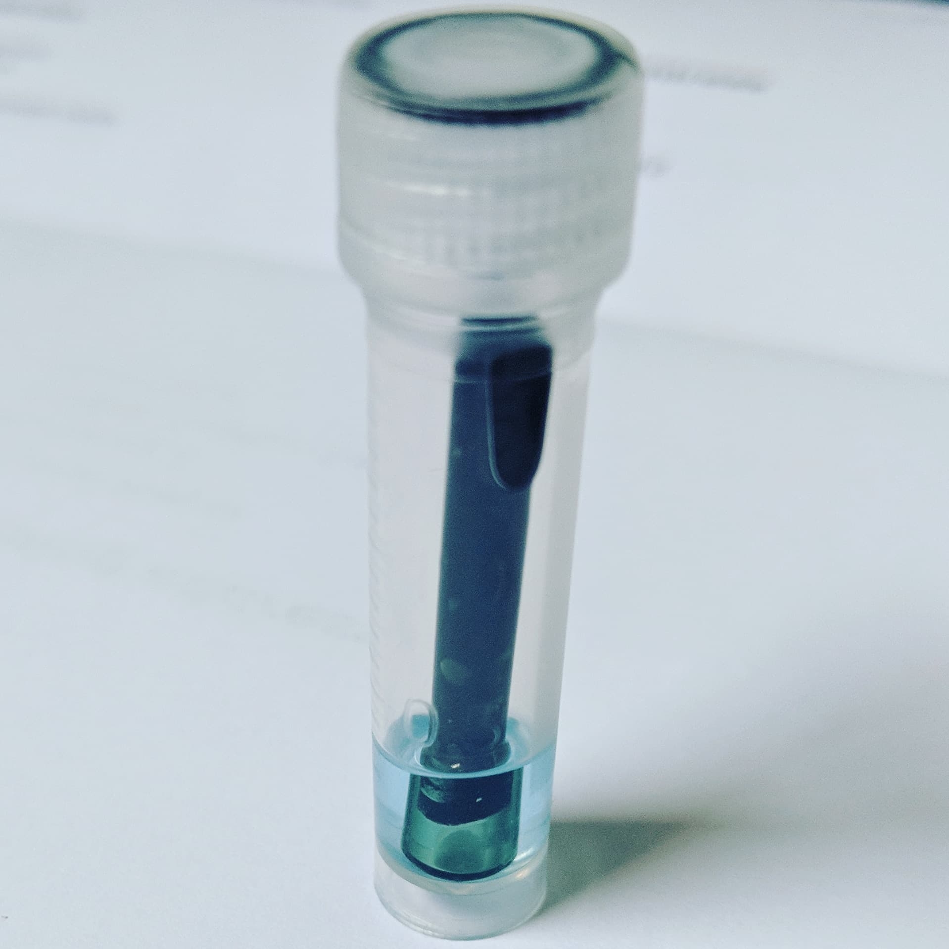

Interesting. Someone just sent me an image that's from Dangerous things showing lead content in rfids ordered from Alibaba. Somewhere in here I was saying, why not? What evidence do you have that it's any different? Well there you go. Maybe someone can find a link. Anyhow, after Defcon I'll repeat these tests. In fact, if like to try it out on a bunch of different ones.
@Cassox I think this should be it. https://forum.dangerousthings.com/t/tests-weve-performed-on-our-x-series-tags/474
Do you know how that lead test is done? My tags arrived and if possible I could do tests and gather further information.
This is the perfect example where the testing justifies the cost. @rodanco this was the kinda thing I was trying to get at before: "A $3 tag is a sweet deal but can you check that the coating is actually what the supplier says it is? Can you check if any toxic additives have been used?". So now including @bentpins at least 3 of us have animal tags available and we should run tests to help inform others.
I found Sodium rhodizonate is a lead indicator
This photo is from my supplier...
They clearly state no lead no toxins so we wait and see if it is true.
grounds for a refund at least if it really does test positive
Yeah. Amal is going to run some better tests. Usually it's either sodium rhodizonate or sodium sulfide. The thing is, it was an extended test period.. a few months I believe. From what I know of rhodizonate it has a week half life or so. In theory, it could be something like something precipitating out of solution rather then a positive result. Also, from what I understand the coloration is slightly off on the pic. When adjusted for contrast it made it look more blue. It's actually a grey/green color. That would be the sulfide. The worry is that the glass is leaded instead of borosilicate.
So here's the pic.
I have some reagents on the way. I'll going to test every type I have. I also checked with Cyberise. He stated that his suppliers were not in China and that he had similar tests performed. He's also going to perform further tests just to make sure.
Does someone want to volunteer to head up a meta-analysis project? We have a shit load of people doing saline tests.. now we have heavy metal tests.. It would really help if someone wanted to put these all in one document and run some stats.
