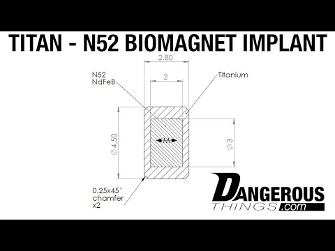

  • Just saw amal post this on Twitter and I'm super excited for it. Just in time for my birthday too. They seem kind of large though.
    2.8x4.5mm?
    Feel like I might as well implant a shotgun slug. DAE have experience with implanting large magnets? I've only done the M31s.

    Hahahaha. That's hilarious. Not quite a shotgun slug. Lol. More important I think is the thickness and it looks pretty good to me. Also, because of the shape, it should slide in.
    So with flex units etc.. they're a bit of a pain simply because you can't grab them with tools. This is like the opposite. It's titanium. Not saying it would be pleasant, but I could probably implant that with a hammer. I actually had a few concerns about it at first. I've spoken to Amal about it and it seems like it's going to be a cool product.

    He hasn't told me the specifics. What would you do if you had funding for the testing worked in to the campaign? I'm thinking extended periods in an ultrasonic bath, and corrosion testing with a few different liquids (acid, hydrocarbon). If it won't damage the ultrasonic then combine the ultrasonic with the corrosion. Maybe literally smash one with a hammer and see if it deforms significantly.
    Inside the titanium shell is supposedly going to be a completely uncoated NdFeB magnet (no nickel or copper) so if the laser welding was incomplete and there were microperforations, or if blunt force introduced a stress fracture, it should be noticeably fairly quickly because of the level of reactivity of the core.
