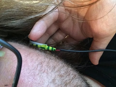

  • I've gotten sound from my finger magnet and an "Invisible headphone" set. The two had to be a couple millimeters apart and the quality was atrocious. I could probably hear well enough to make a phone call but I wouldn't enjoy it.
    As an experiment in making speaker jewelry I tried different methods of attaching magnets and electromagnets and the two biggest factors were creating a small gap from the magnet to the coil and having the speaker diaphragm able to move freely. Both of these factors are complicated by having the magnet inside a finger. You can't get close and finger tips don't want to move freely. The answer is to pour LOTS of power into your coil, which isn't complicated.
    "Invisible Headphones" have a little amp all ready to go, just replace the coil with one of your own and strap the twin 9V batteries to your wrist. I can give this a try on my invisible headphones and see if it's worth the trouble. I will follow up when I have finished trying this.
  • I tried different coil sizes and the best method I found was to wrap the standard coil around my hand three times. Maybe this could be integrated into gloves rather than a bracelet.
    Read the whole experiment.
