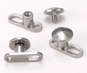

I dont know if this will be useful/possible, but why not use a tubular compass, implant it and then in front of it we put a microdermal like this
And then, on the part that got screwed on the base we build a reed switch, that turns on a light or whatever that notifies us that we are heading to the north.I have a kind of diagram here: -
Of course we will need to charge the thing that will notify us (not on the diagram) -
@Wisven, could you explain the parts in your image? A side view may also help. Is there an existing device that uses similar mechanisms we could examine?@Jack_Sylvane, I like where you're going with that. I think that an external component kind of defeats the purpose but a reed switch is inspired especially if a small internal generator can be implemented to deliver shocks as an electrode.I grabbed a reed switch I had in my tool box and held it next to a compass with small magnets to see if the iron in the switch would interfere with the compass.It did.
