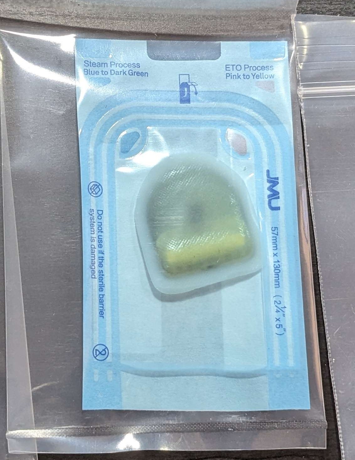

Hey. I've done a lot of work in this area developing an implantable receiver for Qi wireless charging. For a friend I adapted it to be a very powerful light, and she put glow powder resin on it. Attached are some pics of it pre-encapsulation, post encapsulation, then implanted and being powered by a phone.
I don't think an implantable flashlight is a viable option. Even at 2 Watts this light doesn't illuminate the room, and you need an external coil to drive it anyway. Even if you adapted this system to use a rechargeable battery, the attenuation of visible light by your skin is very substantive. She's already getting burned by this setup when it's used for more than 15 seconds. It seems to be partly from the radiant output itself, because the thermal mass of the implant and the active cooling of your blood pumping manages the heat generated within the implant very well.
Apologies for the slow reply, thank you for that. A pity about the side effects, and I can see what you mean. Reminds me of just holding a super bright flashlight to my hand and seeing it glow. I suppose trying to navigate via that would be more of a chore than its worth having to cycle on and off to avoid damaging myself and only being able to see very close by.
I can't think of a way around that, either. Guess this idea is shelved, then!
