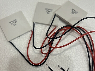

Hey, glad you found the forum! You should buy a peltier thermoelectric generator for a few pounds online and try it out so you have a better understanding of it's performance. Pretty much anywhere inside the body you will not have a sufficient temperature gradient to create any appreciable amount of power. You will need to create a transdermal with a heatsink like you mentioned in one of your later posts, and even then you'll only be generating microwatts of power. If you want to do some research into that space though and try and work something out people here will definitely be willing to help out.

@Satur9 Do you have a peltier thermoelectric generator to suggest ?
Well, availability entirely depends on your region. I'm in the US so I usually would use eBay, Digikey, Mouser, or Alibaba. I've attached a picture of what they look like. You can use search terms like "Peltier thermo electric generator module TEG" and you'll definitely find some. Their output voltage varies considerably depending on the magnitude of the temperature gradient between the ceramic plates, so they're usually rated for a maximum current value like "8A" for 8 Amps. I've also attached a characteristic response graph for several models.
It doesn't really matter which one you pick because I'm just trying to highlight how difficult it is to generate power from such a small heat differential.

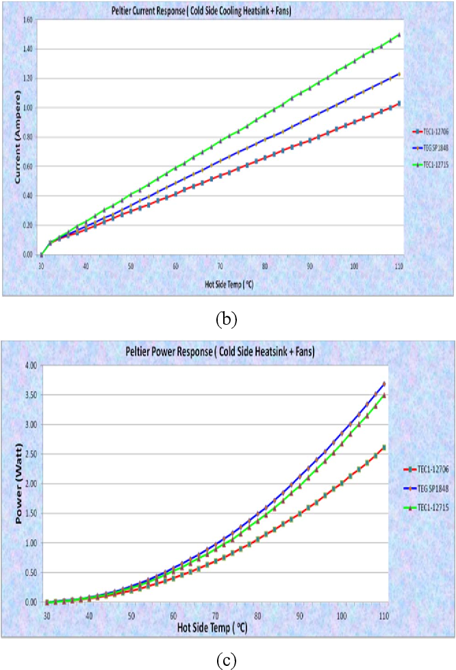

@Satur9 Well it is true that the power is small but we also only want to power up sensors and short range communication like Bluetooth. No need for a lot of power. Plus this ones are 40mm small we can put multiple one next to the other to generate more energy.
You're definitely limited in how much vasculature you can interrupt with these plates, and how much (if any) transdermal space you can maintain on the body to allow heat sinking. Seems like a huge sacrifice for a few mA of power, especially when the average Bluetooth radio is using 10mA+ and sensors consume a non negligible amount of power because of the processor that is necessary to read them.
I'm not trying to be a nay sayer, I just think it's helpful to be practical. You'll get a lot more energy for a lot smaller sacrifice if you use wireless power transfer from an external power source or even something like glucose biofuel cells.
I take that bit about the glucose biofuel cells back. With the most efficient I could find you're only getting 43uW/cm². That's 0.26mA at 3.3V if you have 20cm² of area, and it has to be in contact with blood (not encapsulated in fibrin sheathing).
I mean go for it, try out the peltier modules and see how much power you can get with a soft heat transfer material at 37°C on one side, and air at ~21°C on the other. I might have some lying around if you want me to try anything.
