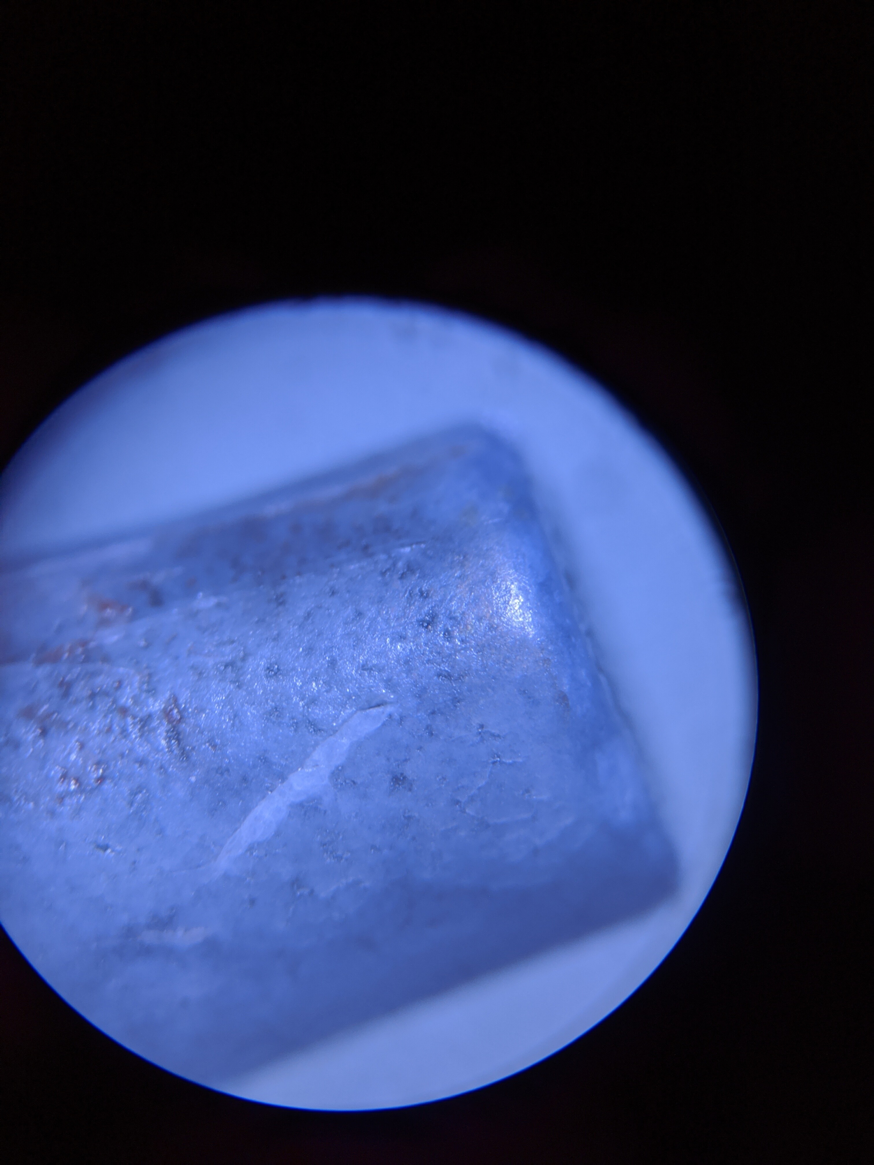

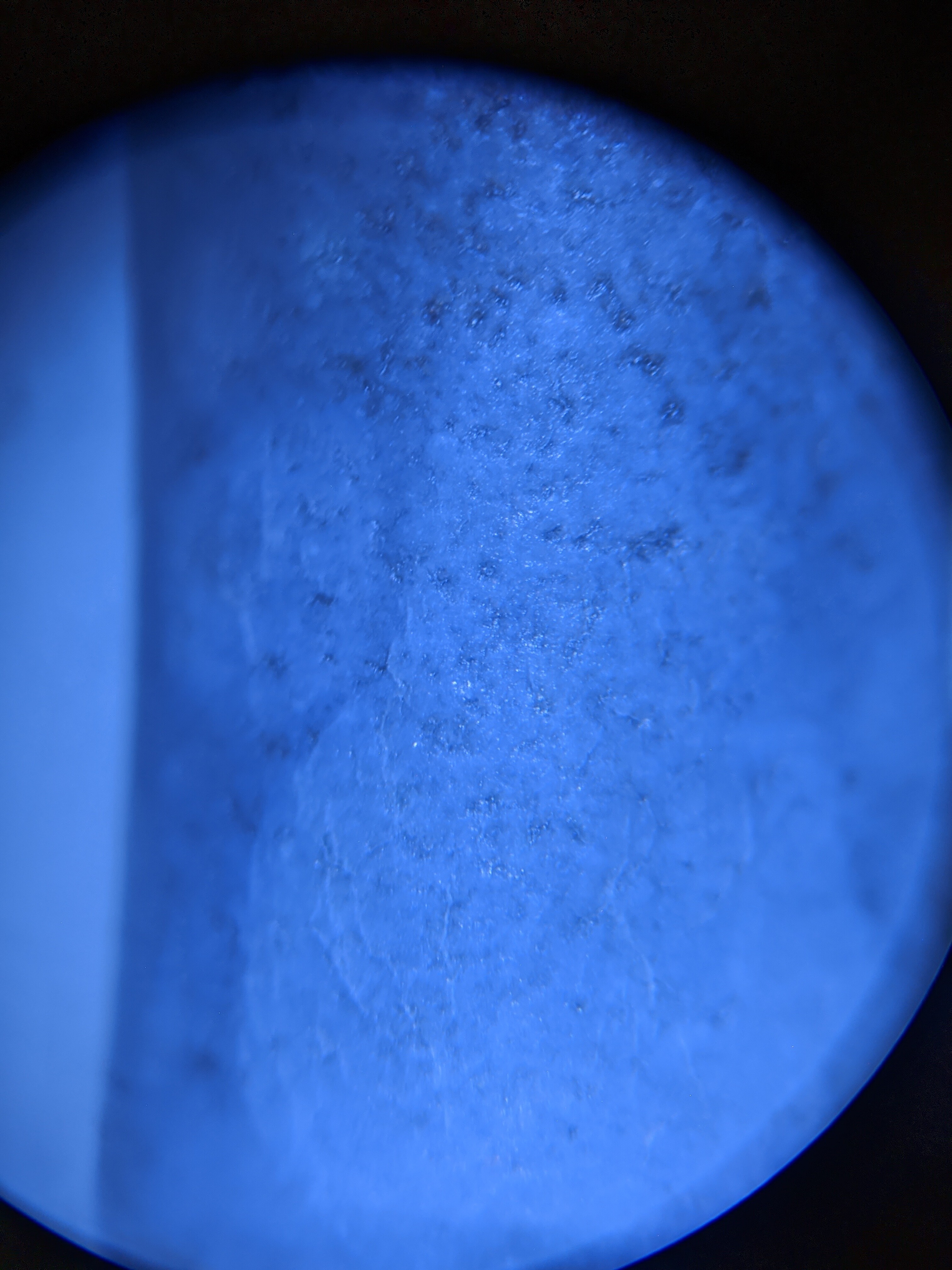

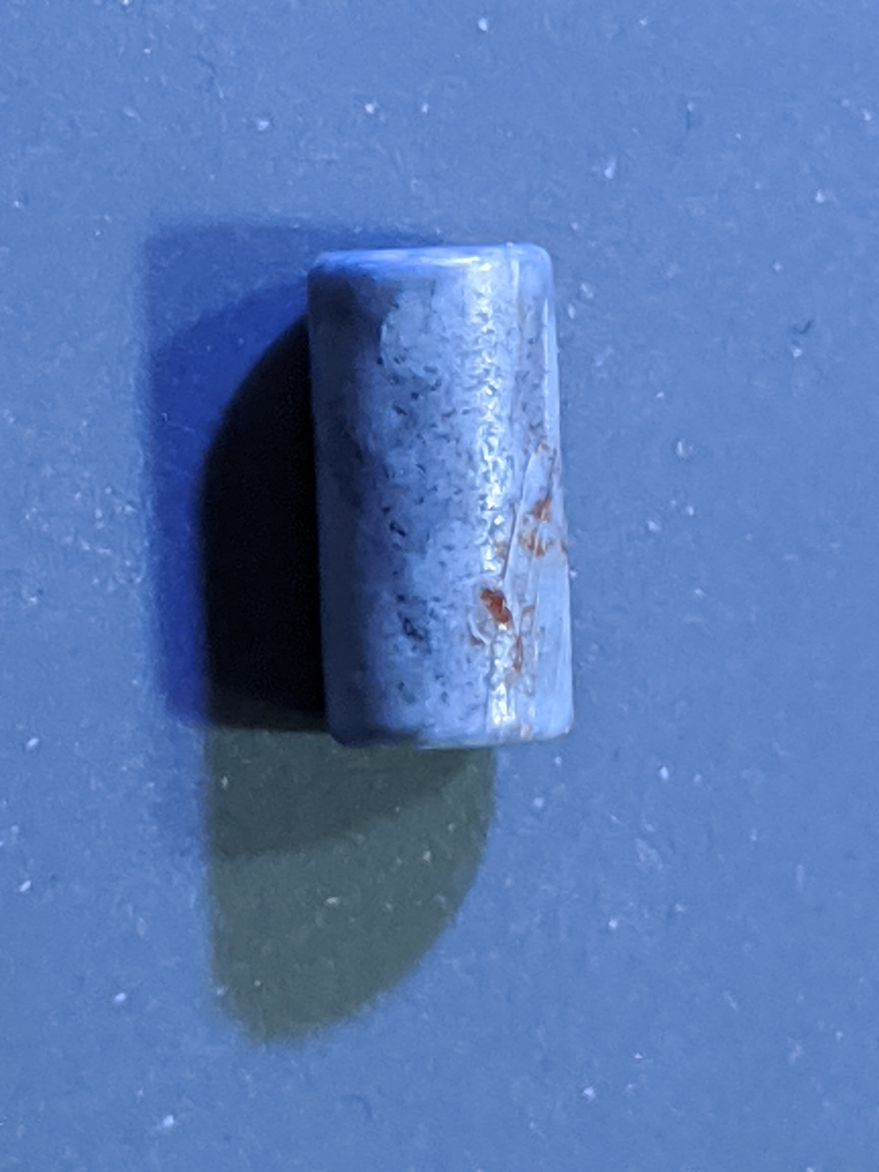

  3. I had a big parylene magnet in for a year and a half and the coating had started to fail. I've attached some pictures. You can see surface pitting, bubbles, and cracks.
    The tough part with elastomers like parylene and silicone is that they're really just a shell, they're not adhered to the magnet in any way. A blunt force trauma like you're describing could have exacerbated an already present crack in the coating, which could expose the nickel plating to your body. This would manifest as an itching sensation if you're one of a large percentage of people who have a nickel allergy.
    Your call about whether or not you want to take it out. If it starts to get red or inflamed, or you notice a significant loss of field strength, that's a sure sign.
