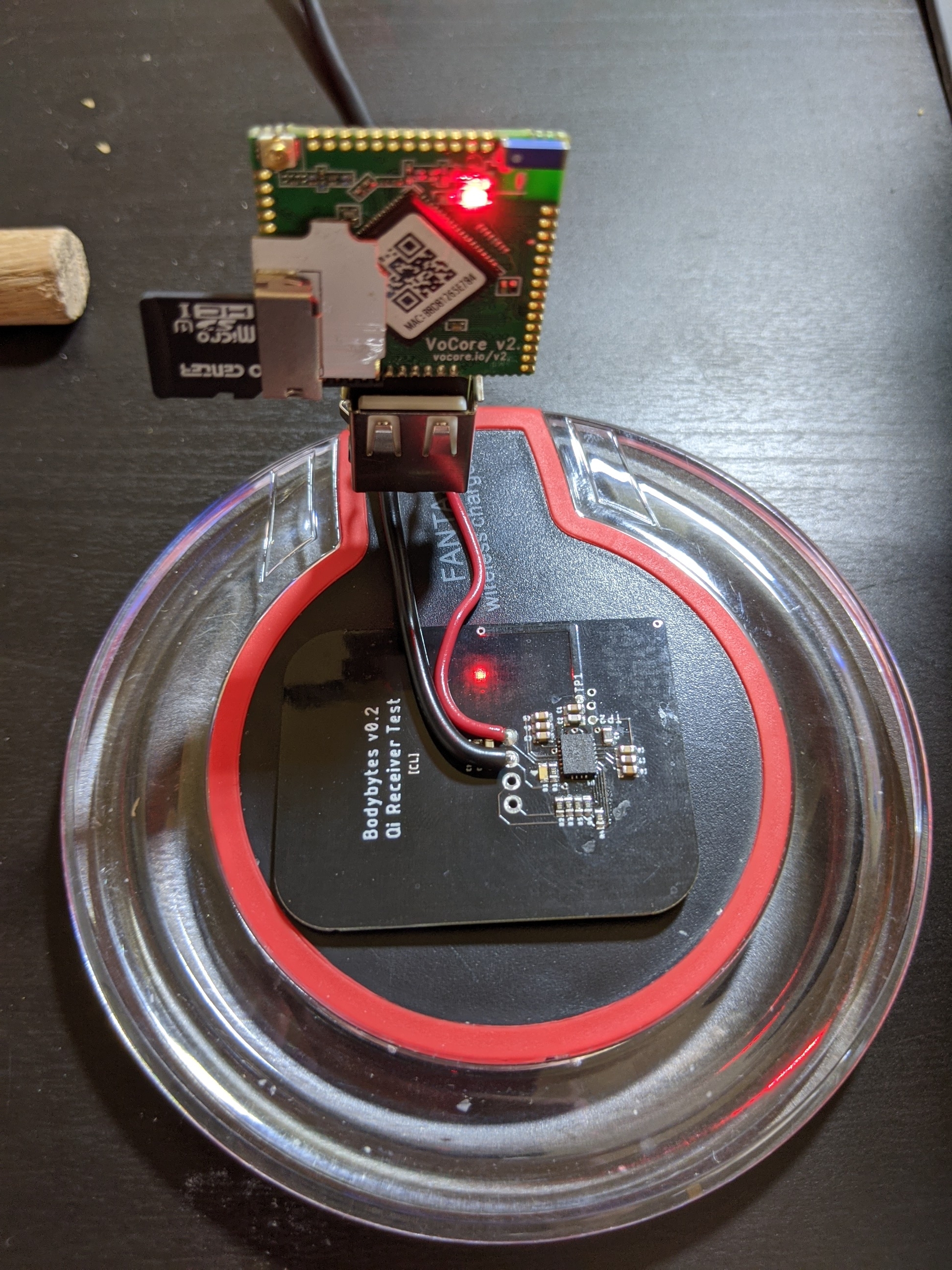

Hey so I know it's been a minute but the Qi receiver in an implantable form factor is coming along nicely. I'm just working out some kinks with the current limit while some other clever individuals work out the code that will run on the VoCore chip. Currently it's Gossa which is a fileserver. Once the Qi charger is more reliable in the next revision I'll publish it open source for anyone who wants to use it as a reference for your own implants.
