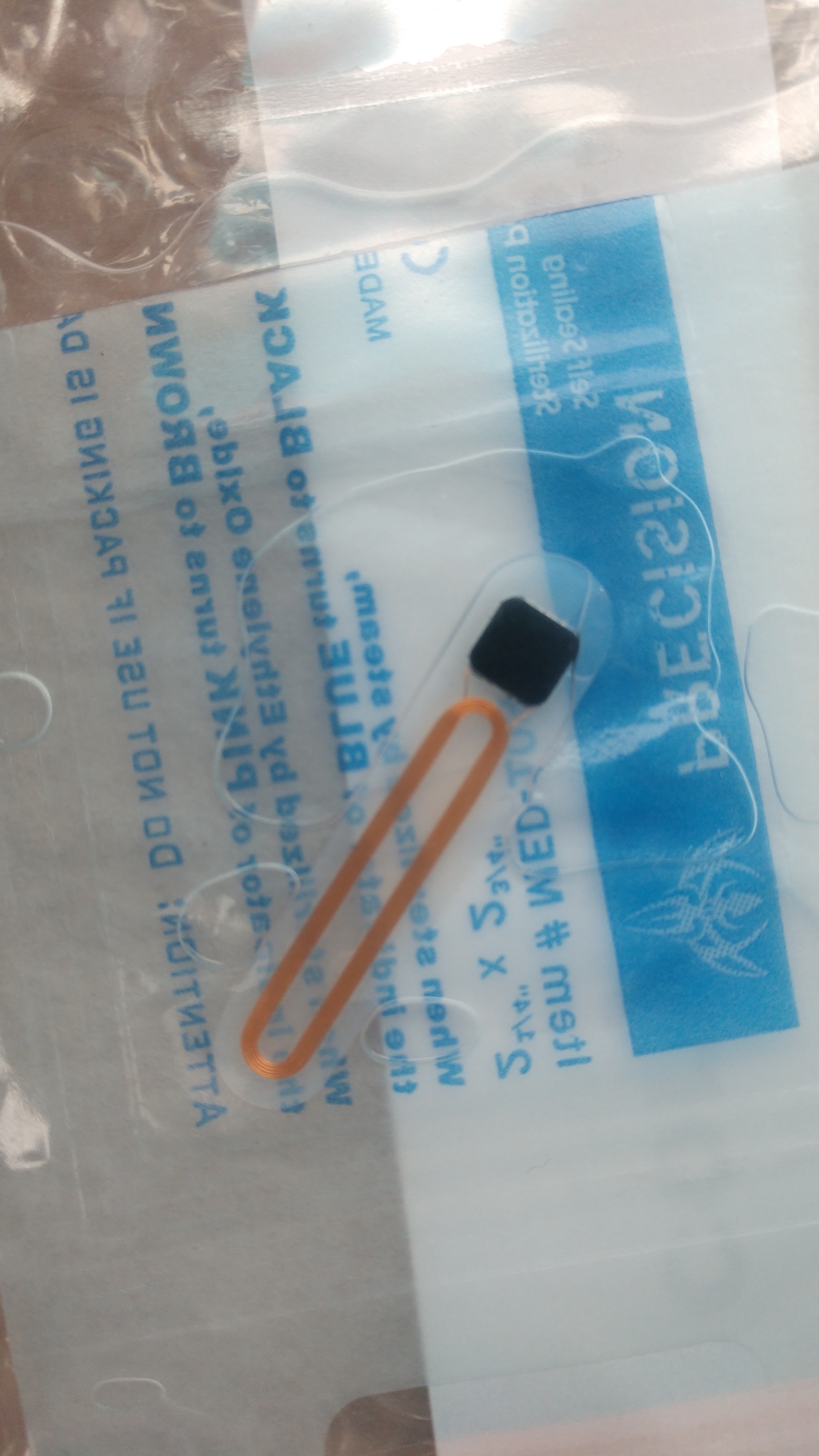

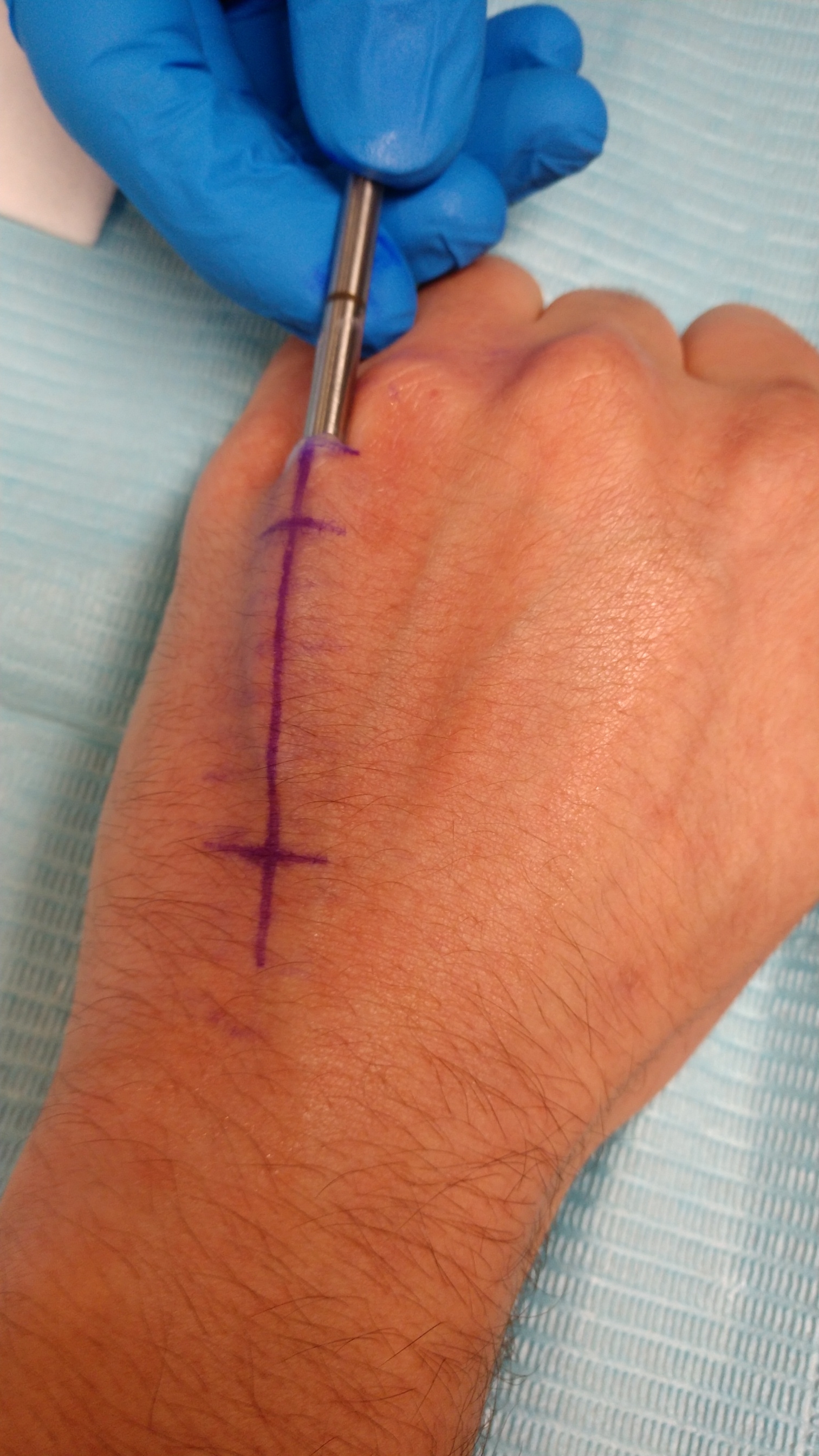

I located a prepaid card issuer in the US called Purewrist. Their terms are not ideal, but there's really nothing else in the US so I decided to give it a try. It turned out that Amal had an appropriate antenna available so we converted it into the flex form factor, and I had it installed yesterday.
It works really well, and I'm currently running in vivo testing with a variety of reader topologies. The flex implants may be available as a regular item on the DT store sometime in the future, but for now you can order a "card" from Purewrist and send it to Amal to be converted just like a microcard. Here's me paying with the implant immediately after installation:

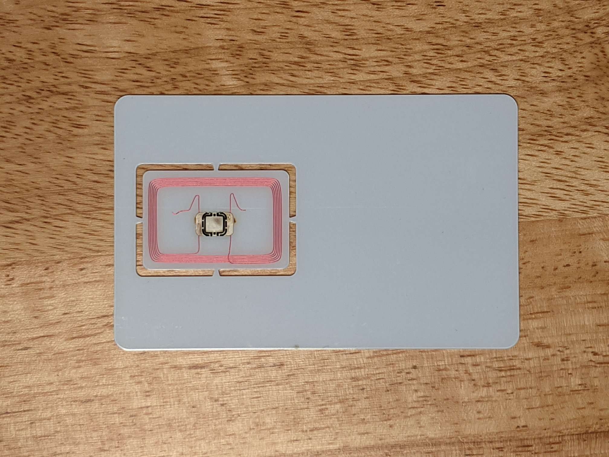

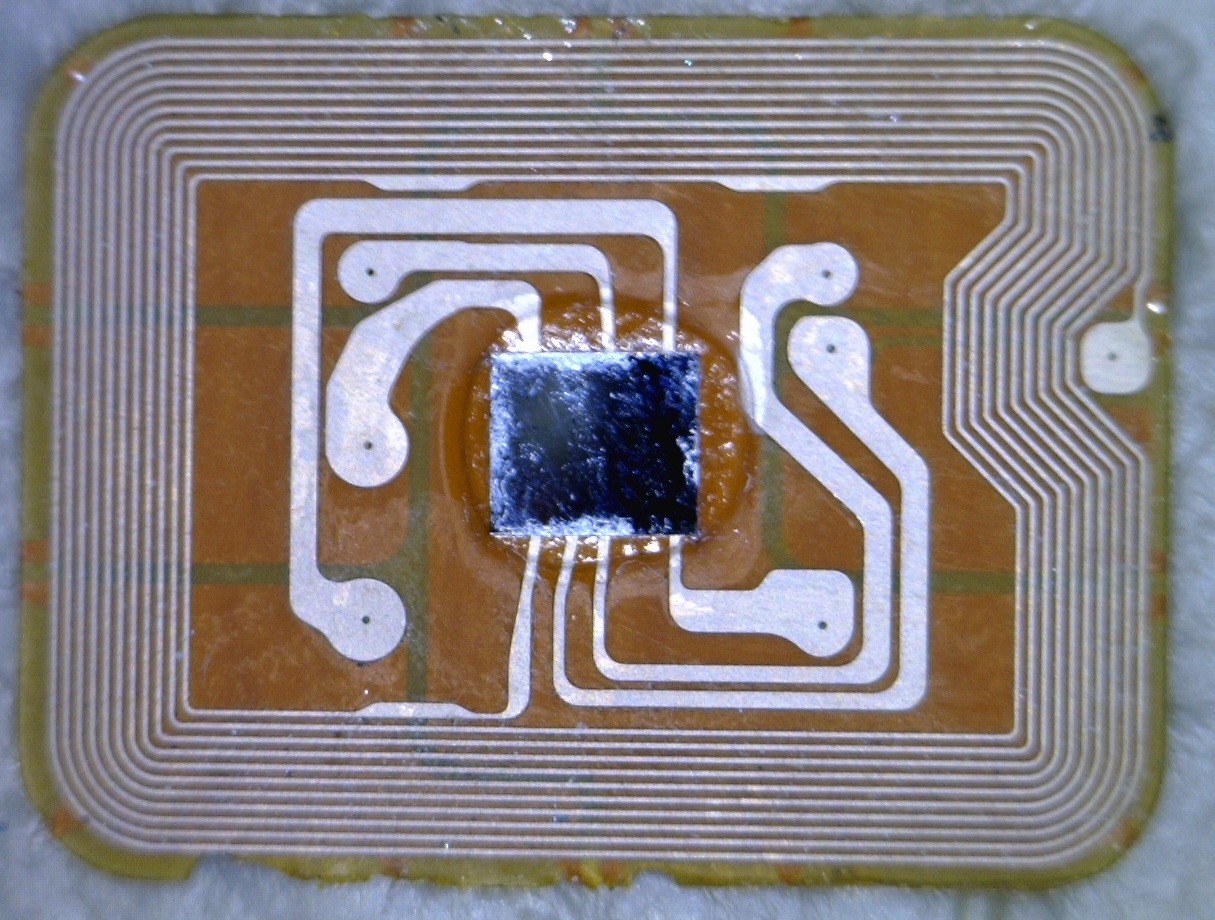

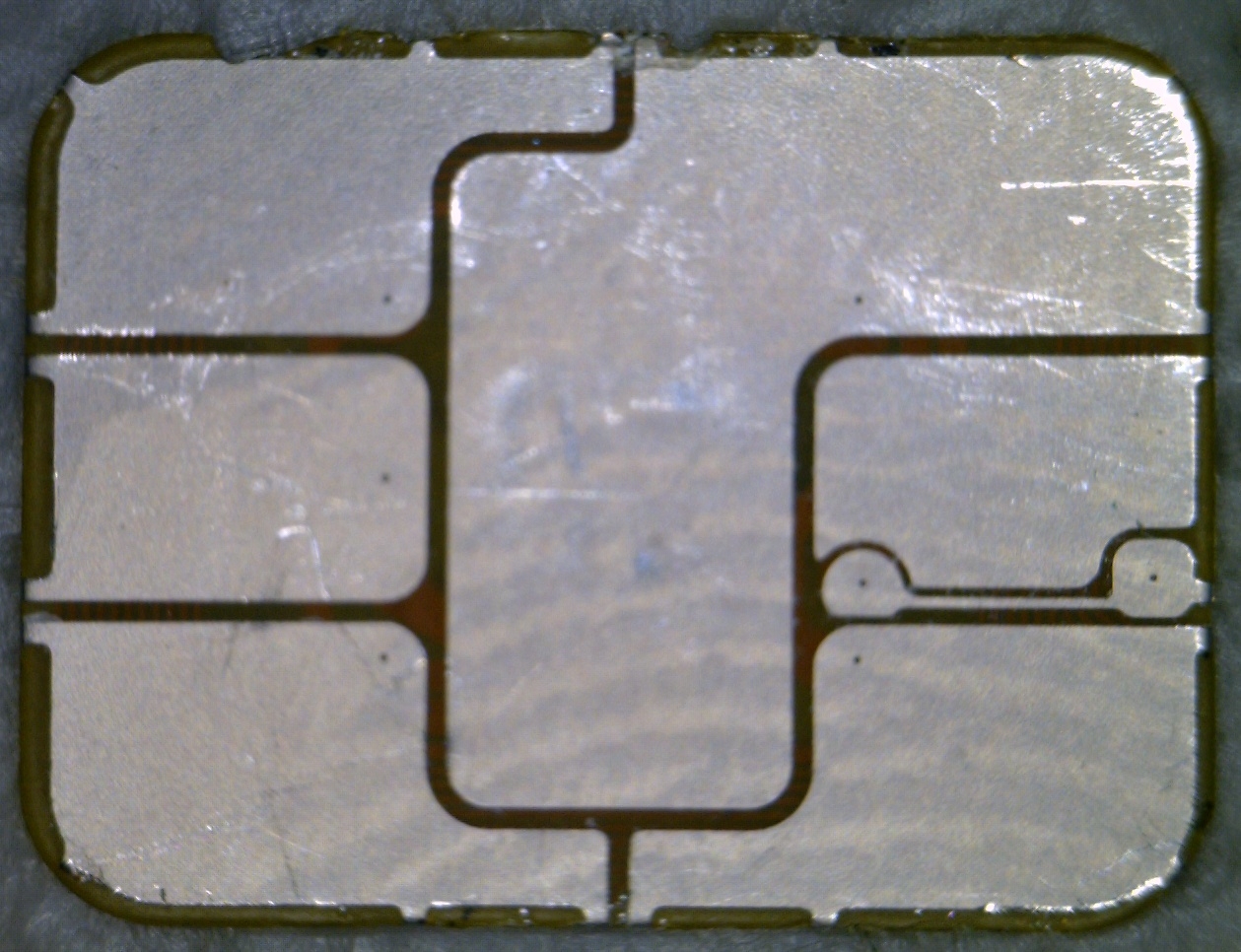

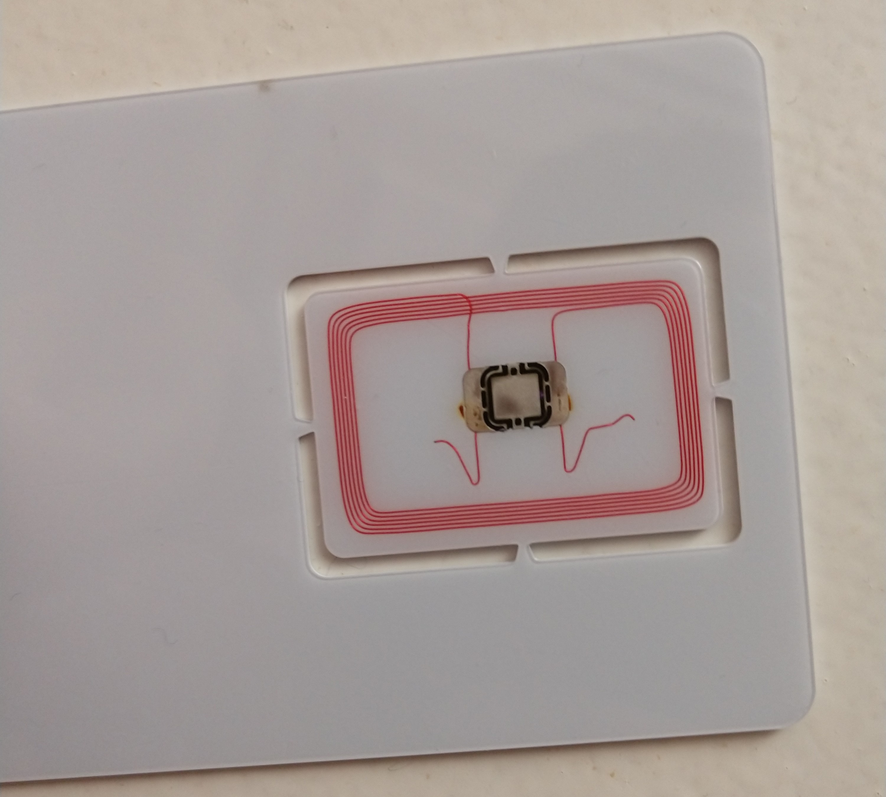

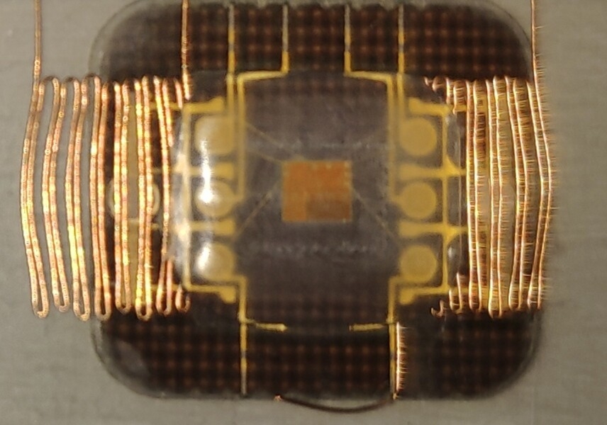

  6. Specifically it's much easier to convert a card if it's a payment wearable because they often use MOB chip packages (pictured above) that have convenient "wing" contacts that are not bound to a contact interface. Dual interface cards have a tiny silicon die encased in resin which is not easy to connect an antenna to (see first attachment)

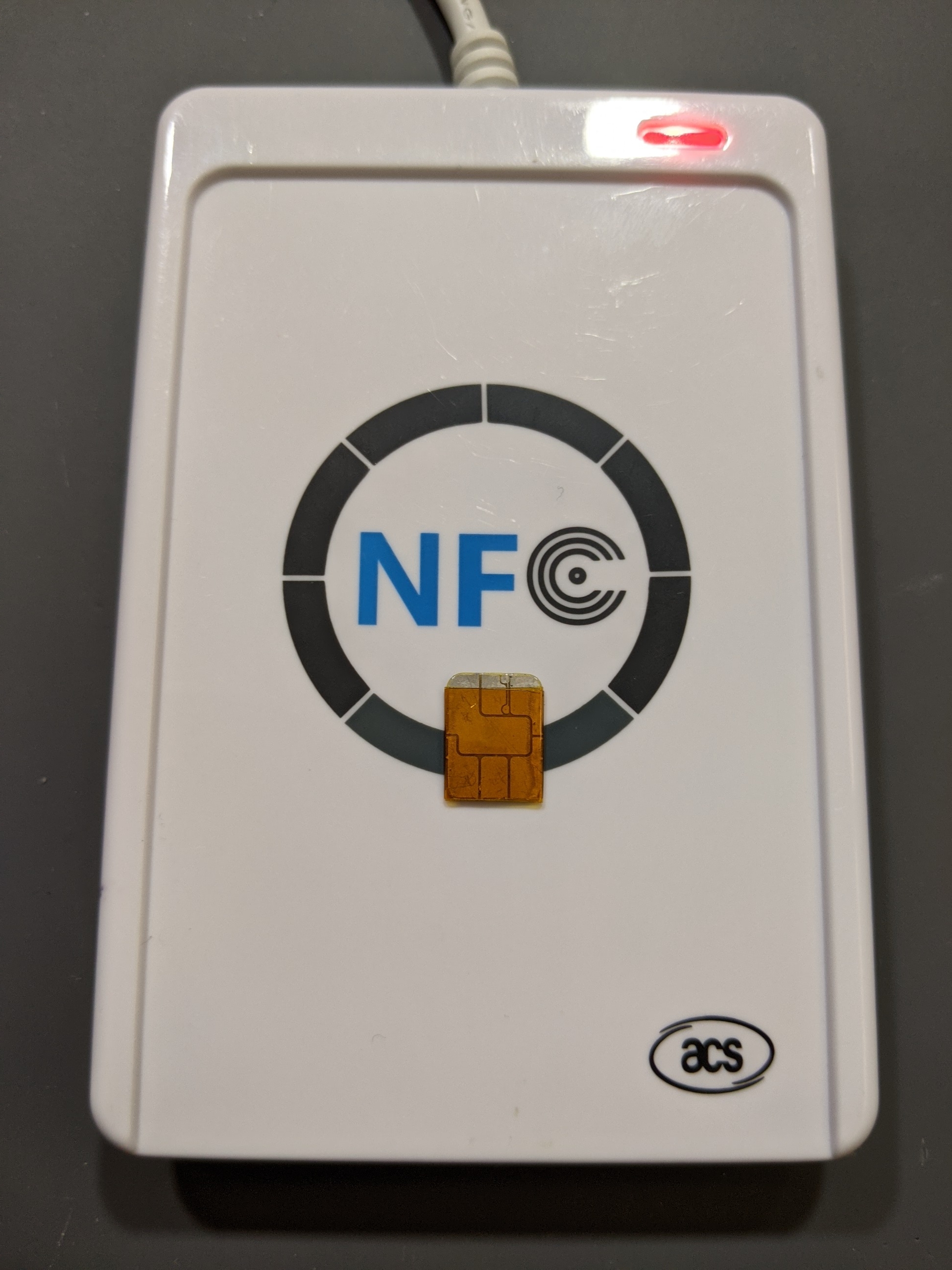

    I'm currently exploring conversion of Coil on Module (CoM) cards, which are much more common, especially in the US. You can see in the second and third attachment the type I'm talking about. If you shine a light through you can see the internal antenna, and most have a little antenna trace visible on the outside (that line at the bottom of the right-middle contact).

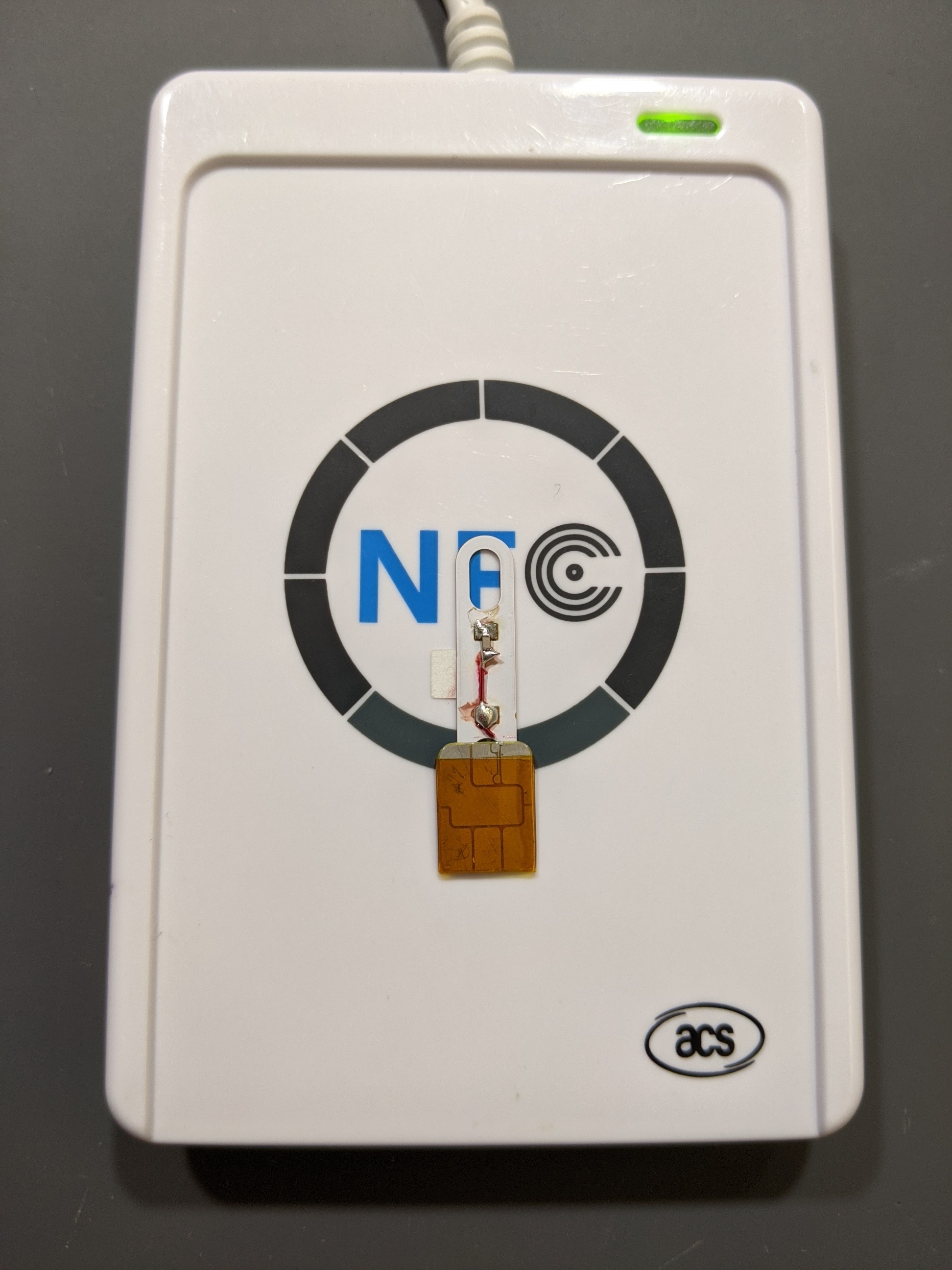

    I've created some little resonant repeater boards as a proof of concept, and they work pretty well. I'll keep you posted as I improve on the design until it's viable as an implant for any CoM module.

  10. The design worked well, but it was difficult for Amal to encapsulate because the z-height of the tuning capacitors was too great. My next step is to revise the design so that the tuning capacitor is two plates in the copper of the PCB. That's likely going to require two revisions to get right and ordering flex PCBs is expensive (~200USD). I just purchased a CNC pick and place, so until I can start getting returns on that investment I've put this project and the bodybytes on the back burner.
