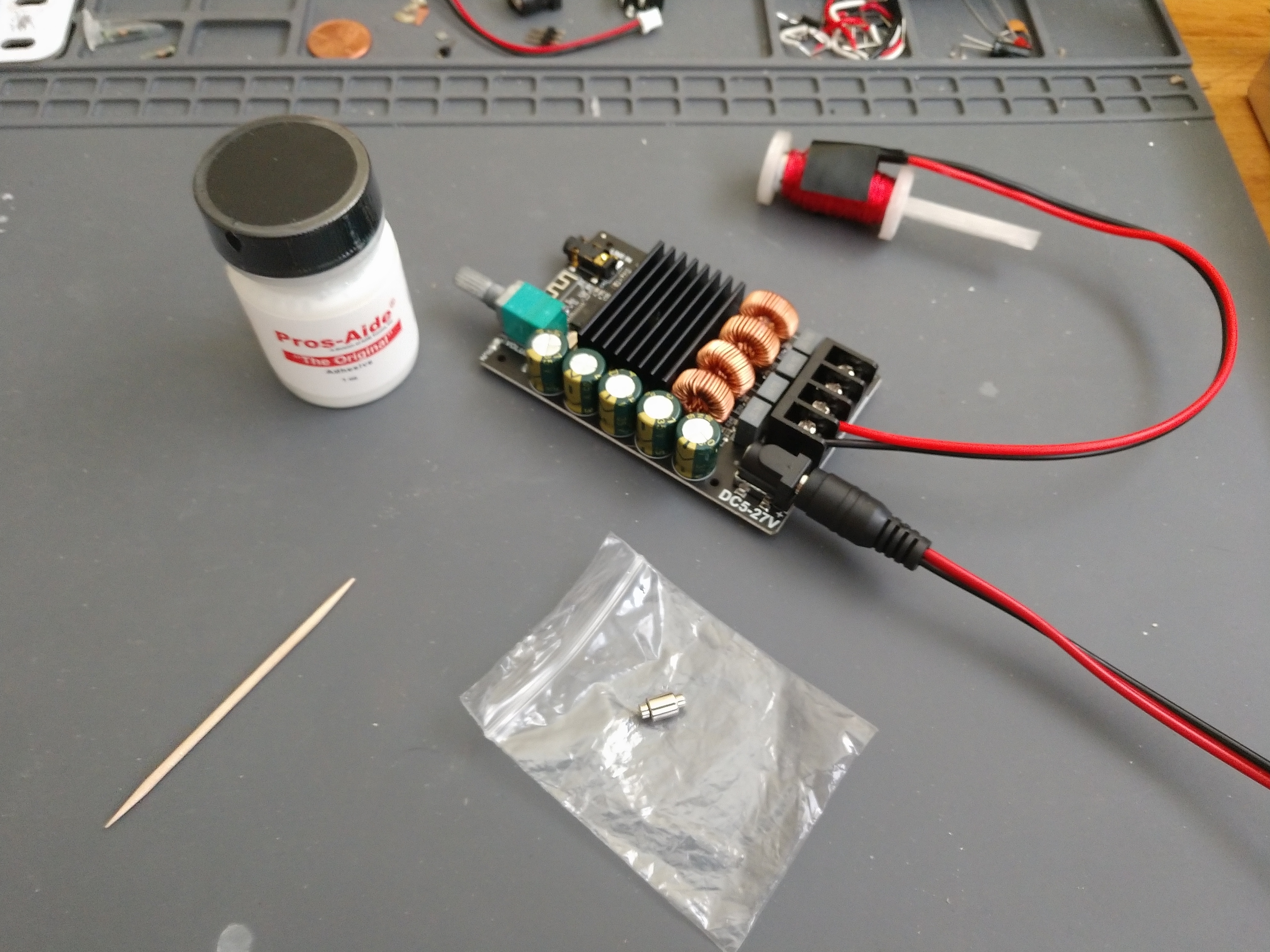

I'm trying to make the implanted magnet in my tragus work as a wireless earbud, but I'm having difficulty. The area it's implanted in is soft and dampens sound transmission, and the mass of the xG3 is too great. Even with a special coil I made with a mu metal core being driven by an amp at more than 50W I still couldn't hear sounds clearly from more than 5cm from my ear.
I really like your earring idea. I'm going to try it out with a small clip-on version first and see how well the sound transmits. If it goes well I'll get a piercing there and use an ordinary stud earring with a tiny magnet mounted to it. I'll let you know how it goes.

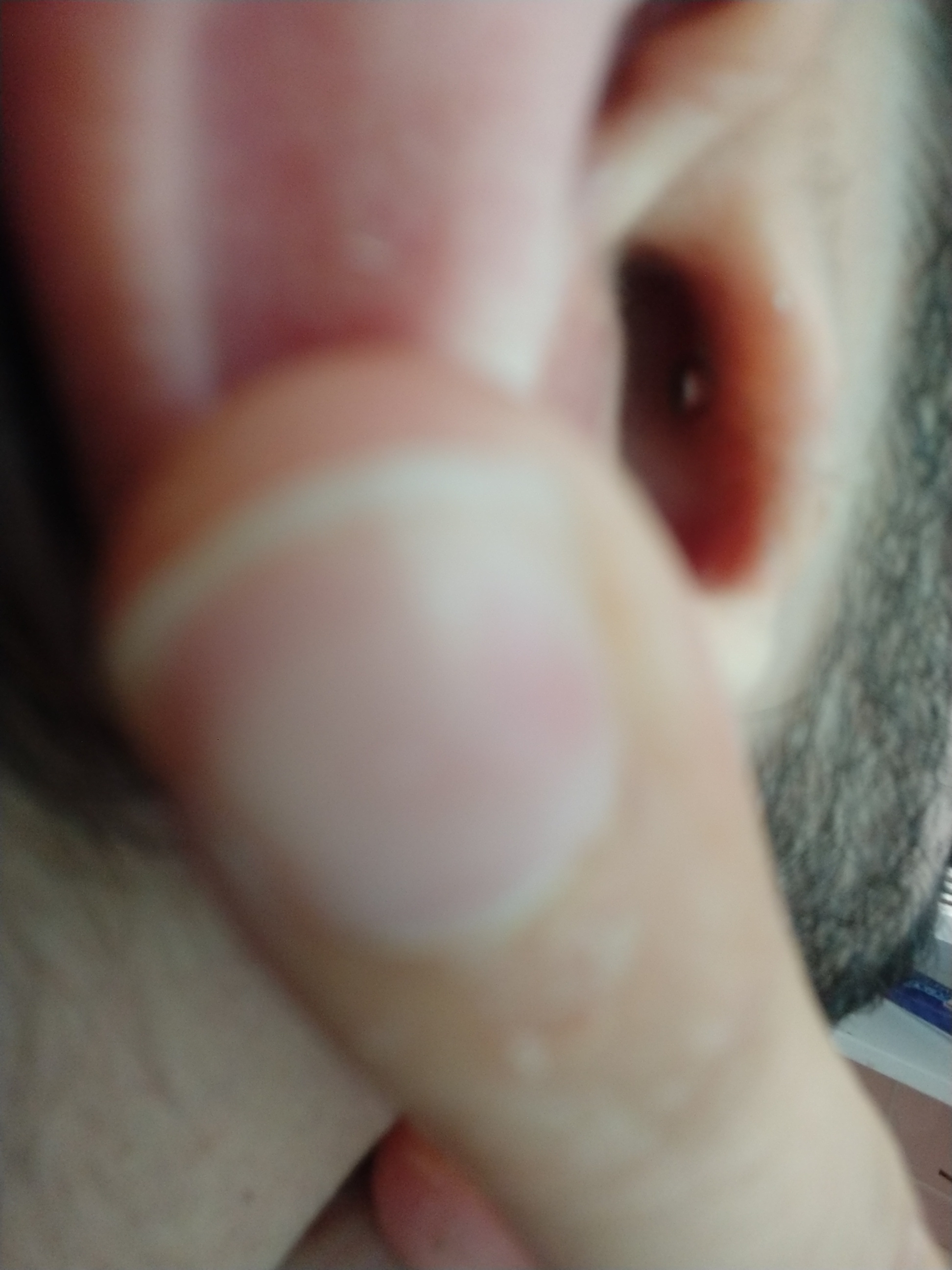

I ended up using pros-aide to glue the magnet to the interior of my tragus. It worked about twice as well as the xG3 I have implanted (fidelity and range) but it still wasn't even 10% as good as dropping the magnet into my ear canal. I also have concerns that a stud earring in the tragus would cause irritation as the magnet vibrates.
