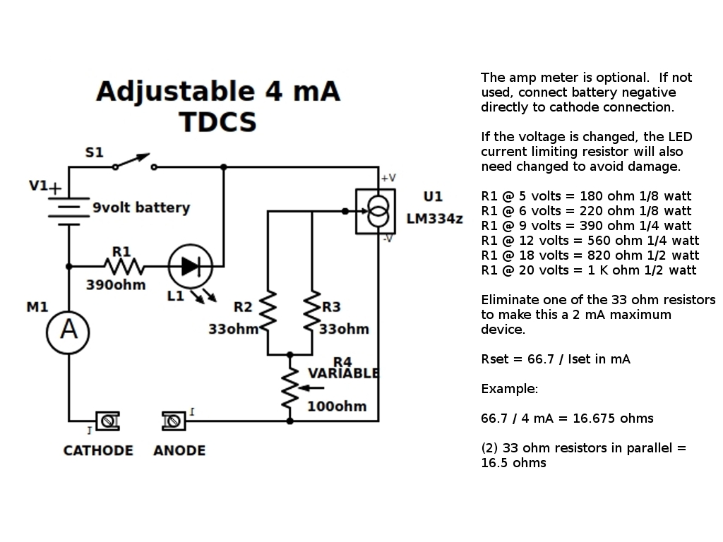

I built another homemade device with a full 2 mA which worked like my old Ebay one but I still had the poor homemade sponge electrodes.

I redesigned my old schematic to add in a potentiometer and meter and increased the maximum power to about 4 mA. I wouldn’t recommend skipping the potentiometer if going over 2 mA. The meter could be eliminated but it helps to know that the electrodes are making good contact. The LED power indicator is nice but I left it out of the test device I built and I also skipped the switch just because I didn’t have one and I just unhook the power to shut it off. Without the LED light, just removing the electrodes should shut it off but I like to either have a switch or remove the battery to make sure it doesn’t waste the battery when not being used. I couldn't really tell much difference between 9 volts and 18 volts besides possibly allowing the electrodes to be further apart but I calculated the changes to use different voltages without blowing out the LED. I don't know if lower than 9 volts would work.
I know that 2 mA was (and might still be) considered the maximum “safe” current but I like having the extra power especially if trying to place the electrodes in positions with hair. The potentiometer allows lower current settings so it doesn’t need to be used at full power. Use your own judgement if you build this circuit or try higher than 2 mA current. The sponge electrodes and the saltwater electrolyte are an important part of this device. If anyone is interested, I can describe what I have used on homemade devices.
I just noticed that the bottom connection on the schematic should have been on the center pin of the potentiometer. It should be almost a short circuit when turned all the way clockwise so check which outside pin to use if you want clockwise to give more current.
With the parts I used, the minimum current is about 0.5 mA and the maximum is just over 3.5 mA and not the 4 mA I designed it for. It might be the cheap, Chinese potentiometer I used but it still works pretty good.

Also: Why do you need more amps if you have hair in between?! Shouldn't voltage the only problem, since all resistance are in series?
Or does the hair make a short circuit directly to the arm ...? :) -

The extra voltage helps mainly if you want to place the electrodes further apart. At 9 volts, placing one electrode on my head and one on my hand didn't even get up to one mA. At 18 volts, I can get the full 4mA or can adjust the current with the potentiometer down to whatever level is comfortable. Many times the current needs to be ramped up slowly to keep the pain (and possible burning) to a minimum. By slowly increasing the current, the stinging sensation is eliminated.
The extra voltage and current does allow the electrodes to conduct through hair better. The sponges need to be wet with the saline solution enough that the hair is also wet in order for it to conduct the electricity.
