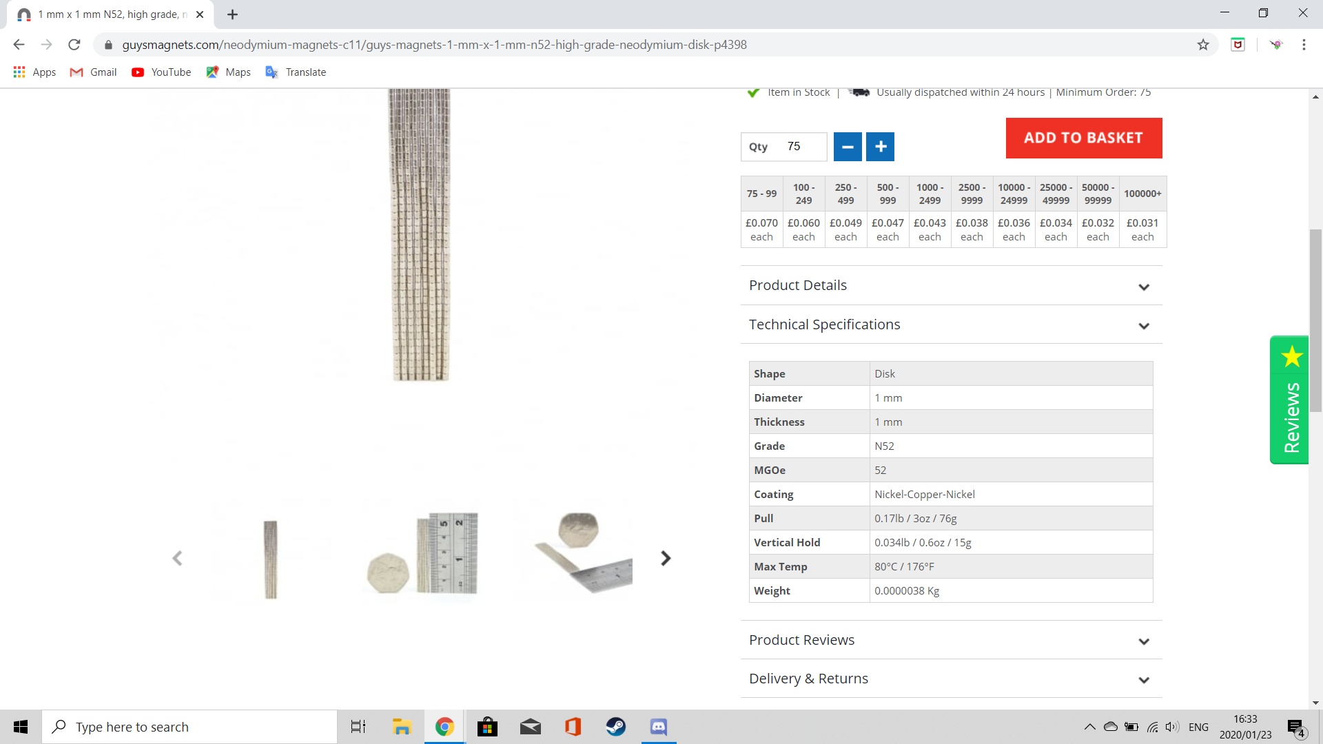

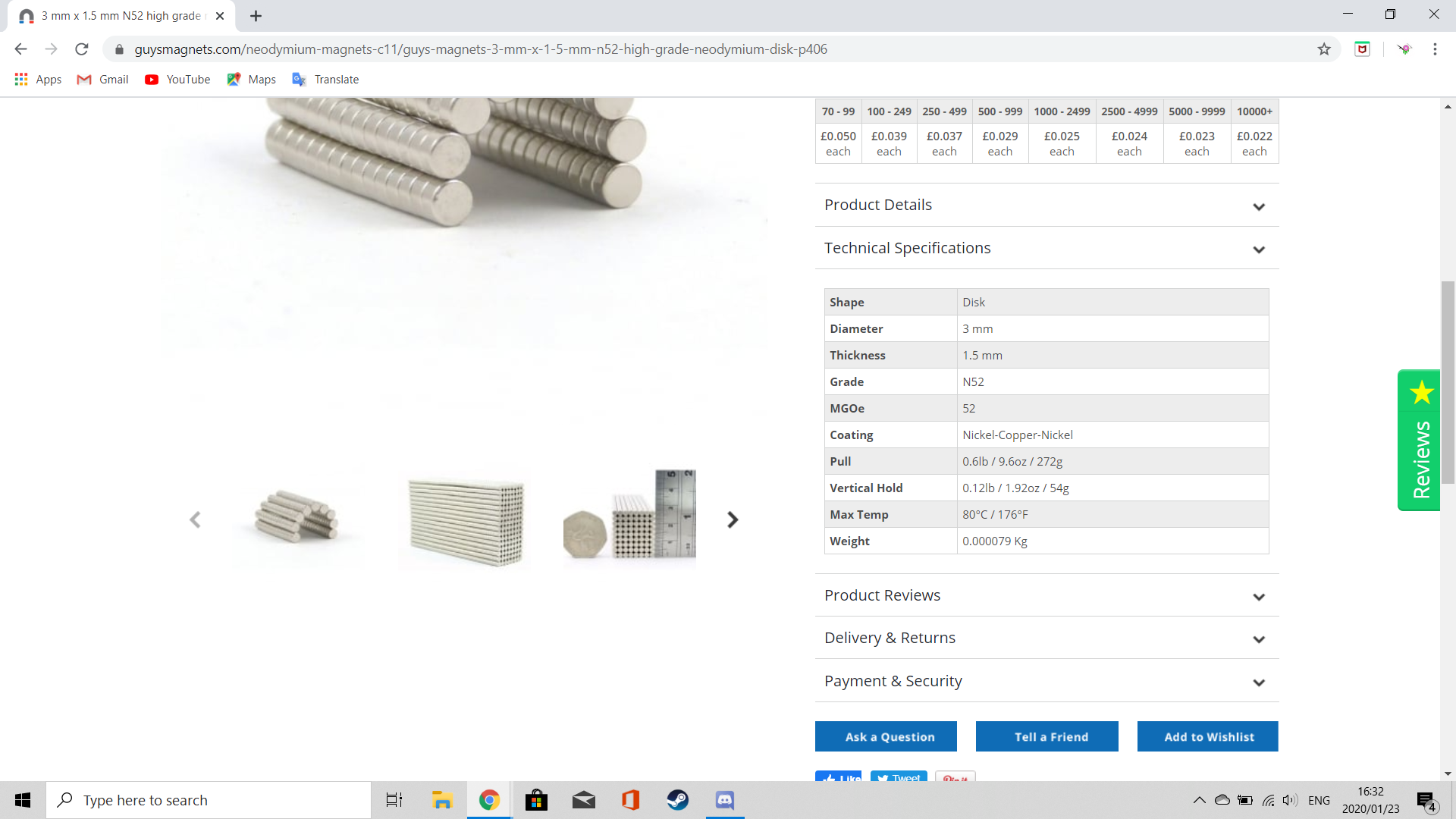

These are the two magnets that I want to implant. The 1x1mm magnet I already implanted in my left pinkie on the right side. The 3x1.5mm I want to implant in my left hand as well. -
