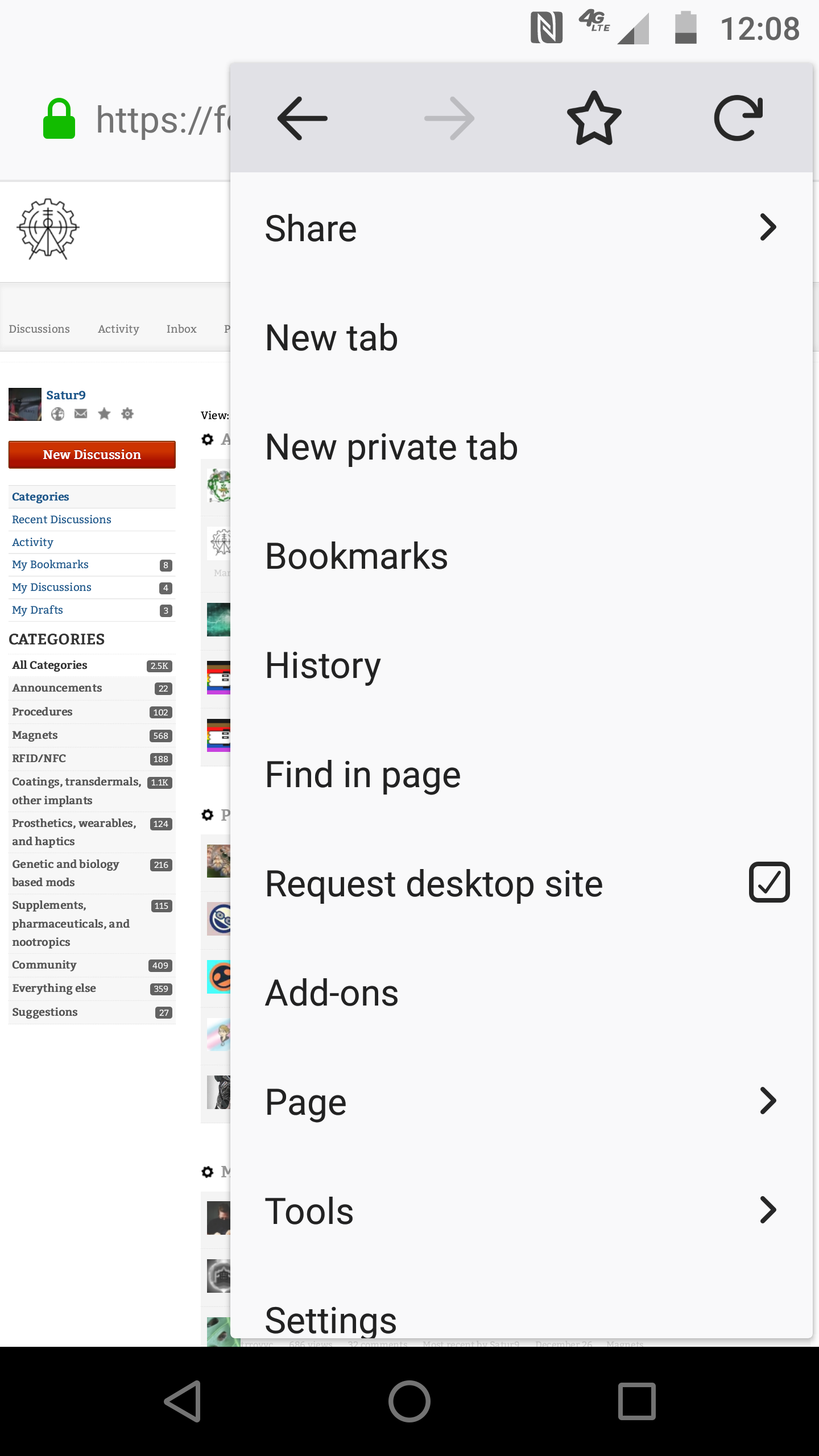

  3. You can access desktop mode on your phone browser. Just go to the menu and check the "Request desktop site" option, or equivalent (See attached). The search bar will be in the top right of the page. Please don't necro threads that are more than a year old.
