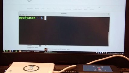

An image being worth a thousand words, here's a video of me authenticating under Linux with my NFC implant (left hand) and my RFID implant (right hand):
