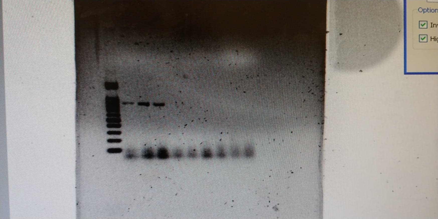

Tl:dr 1 gene down, 1 to go. Next week we clone the isolated g418 gene into the plasmid to make our new standard empty yeast plasmid which will be released for people to use. Should have the silk gene shortly as well and the finished plasmid.
What's in what lane? And does that mean the paper-based extraction didn't work?
In any case, very exciting!!
The three that worked are all from the same thing just at three different annealing temps. Though the cycle was run with a gradient decreasing in temp each cycle by 1.2 degrees. So in order it's 72, 68, and 65c.
But ya paper based didn't work but since neither did column extraction we suspect it's an issue with our lysis procedure not the extraction method itself.

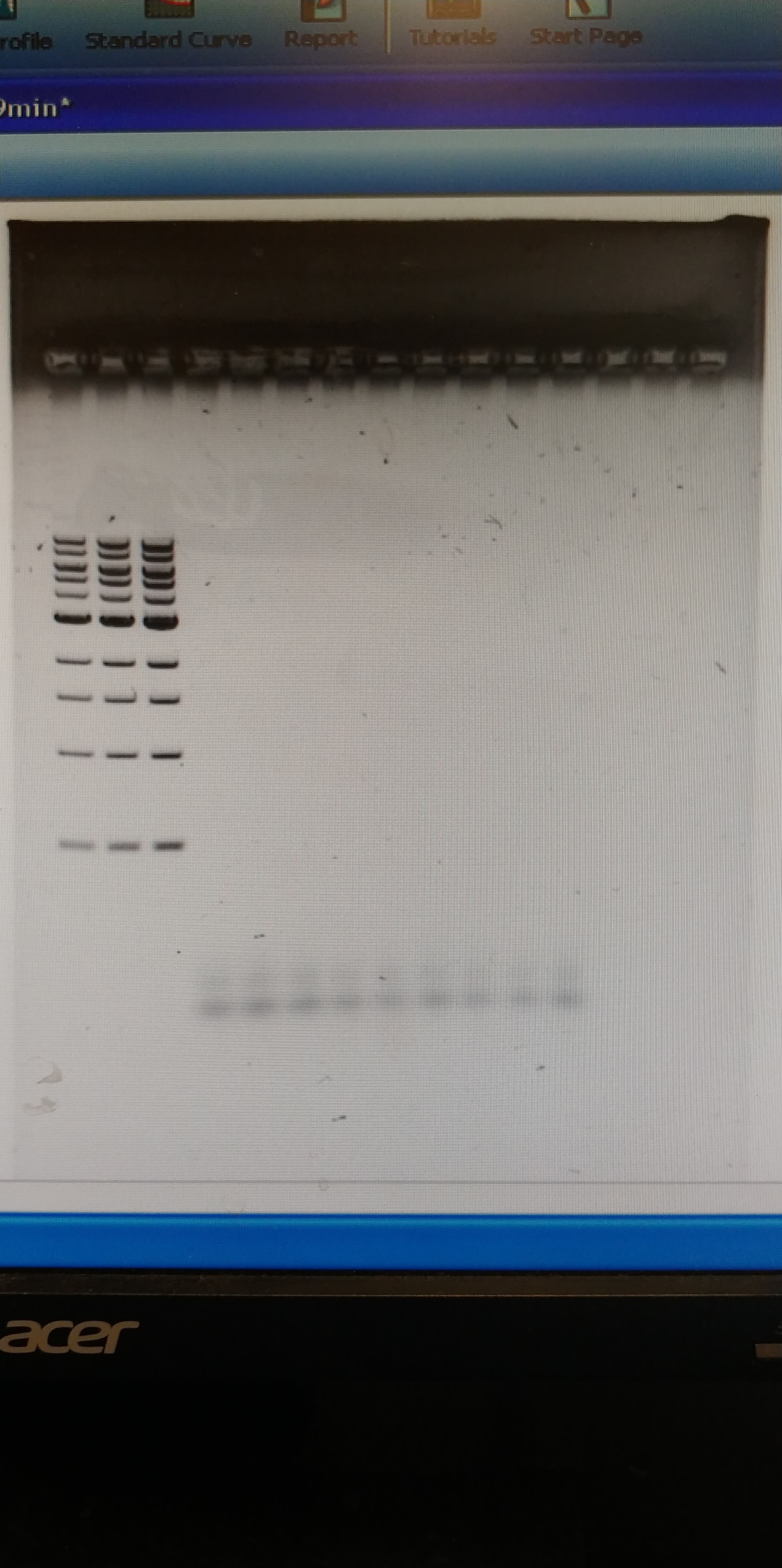

Ran another extraction today. At this point I just assume it's garbage so I'll be excited when it finally does work. Used a professional kit this time. God damn was that a long procedure. 27 steps, some loop back, and some have up to a 4 hour incubation time. I had to make my own chloroform and find a weird alcohol to make this work. I really hope it just works so I don't need to do that nonsense again. Gonna test it and then try and PCR it in the next couple days if all checks out. Ordered and received the shorter primers that don't have the gibson ends on them. Should increase PCR efficiency a lot. So it looks like things are tentatively stacked in our favor for some success soon. I remain skepitcal though. Might run it on a gel tomorrow just for fun. There's been lots of other side project successes, but will discuss those another time.
Test results came back. Got lots of DNA, but when we ran it on a gel it all looks sheared to hell. Still gonna try PCR, but we're starting to suspect that the preservation method of our source spiders isn't good and the DNA degraded. The ethanol prevents them from rotting, but not the nucleases from working. If we're lucky PCR just works and this won't be an issue, but if it is we're gonna need fresher spiders.
