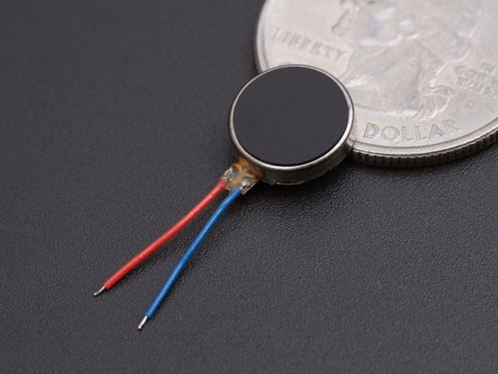

Found some 2 mm thick vibration motors on that might work.
Should be useful for any other projects that require compact vibrating components so I'll link it here.https://seeedstudio.com/Mini-vibration-motor-2.0mm-p-2300.html -
Those seem like a good place to start. I don't know your experience with microcontrollers so be aware that these are 3V. Otherwise, they're pretty easy to use and you'll definitely be able to feel them. They didn't put a current rating on the motors so you may want to use transistors between the motors and your controller.

I recommend starting with an Arduino UNO or a clone and those motors. Pick up some 2n3904 or 2n3906 transistors.
Arduino Uno [eBay Link]
Disc vibrators [eBay link]
3904 transistors [eBay Link]
3906 transistors [eBay Link]
This should be enough to whet your appetite without breaking the bank. You may not need the transistor but it may be better to order them before they're necessary. -
