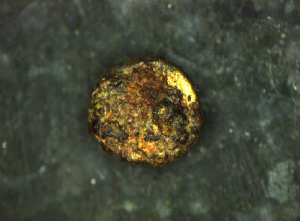

I'm not an expert, but I have sourced a TiN coated magnet from an ordinary manufacturer and implanted it (like you're proposing). The coating is so thin, and the magnets are treated so roughly, that it would be nigh impossible to source a commercial magnet that does not have microscopic cracks and fissures in the TiN, which allow your body to break it down. I had to remove mine after a year. I've attached a picture.
Silicone is a pretty reliable coating method that is not difficult to master, although it dramatically increases the size of the magnet. You could consider buying the magnets you talked about and add a second silicone coating yourself. Just make sure it passes at least the salt-bath test.
You could also check out other posts on the forum that talk about coatings magnets in thermoplastics like HDPE or PET. Just remember that many coating methods require heating. If the magnet is brought anywhere near its Curie temp, it will dramatically affect the field strength.
