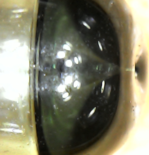

  6. I'm in the process of creating a machine that seals them with an IR laser.
    The current state is that I'm waiting for the glass to arrive so I can perform further tests.
    I only had a hand full of tubes so far and I've used them up already.
    The whole project is quite experimental, and most people that I asked about it outside of the biohacking community told me that it wouldn't work. Some called themselves "laser experts" and told me the glass wouldn't even melt and shatter or I would only engrave it. I went on anyway with the project and gave a fuck about those so-called experts.
    It's all janky diy right now and I went in debt, so I can afford everything, but I hope it pays off some day... I'm confident.
    Here are some microscope images I shot today for troubleshooting the imperfect seals. Some tubes failed in the vacuum chamber, and now I know the reason.
